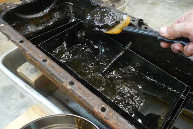

I recently acquired a 1951 eight that last ran about the same time your car was stored in the woods. I am carefully following the advice which is offered in a topic that is in the "Hudson" strand: "I just bought a 1937 Terraplane Super 6". (Last posting October 2014)
This involves removing the oil pan and the dipper pan ( removable after taking off the oil pan) before being tempted to rotate the engine. On my engine, I found that most of the oil in the dipper trays had turned to a semi-solid mass. This would have plugged up the dippers on the connecting rods if I had rotated the engine.

I feel compelled to re-enforce Per's recommendation that you resist that urge to " make it run" without first doing some prep work. Here's an example (albeit extreme) of what you may find in the pan.
