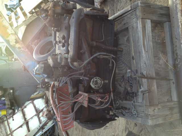

Hello , last year I bought a 8 engine from the thirties in California and got it shipped to me here in Norway. Now I have started to dismantle it to rebuild it. It had a aluminium powerdome head on it and a extra original cylinder head to go with it. Is it someone here that can identify the differences between each year? It seems like this engine has some kind of pressurized oil lubrication system on the outside of the engine? The engine number is 13096. If that helps. And finally is it possible to buy the timing gears and if so is it in any other material than bakelite?

Can you post photos of the engine?

(@Raymond Robberstad)
Hi there just too many cars and stuff to work with, at the moment it is just disassembled for cleaning and I do not think i have the time before winter to do more with it. Will post photos soon.

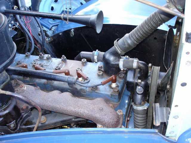

And here is my current engine in the car.
