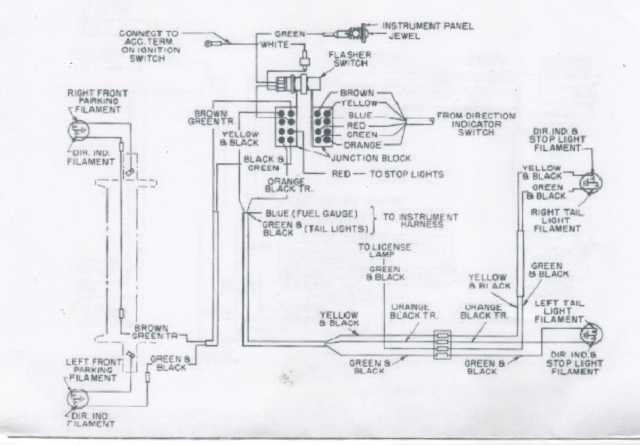

I have the wiring diagram for the 51 OD wiring harness. It shows the color of wires but not wire size.
anyone have this info?

All the OD wiring is 16 ga. except for two pieces that should be 14 ga.:
(1) the one that goes from the BAT terminal of the VR to terminal 1, the "fuse terminal" on the OD relay, and
(2) the black wire that goes from terminal 4 on the OD relay down to terminal 4 on the solenoid.

Park, is the Regulator BAT terminal to fuse Black?
Thanks!
Now another question-- The turn signal wiring diagrams show the color but not the size. Can anyone help determine the size wiring for those?

Kerry, the book doesn't show a color for that wire, but I'd use black for consistency in that circuit.
