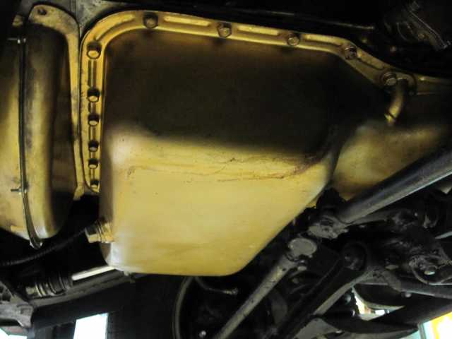

(@Richard Dryman)
My dipstick is 8-5/16" from stop-washer to full and tube in block is 3/4". If that is like all the 308's then I need to add about 3 more quarts to get around the middle of the marked range on the stick. Owners manual says it takes 3 1/2 qts within the range. That means that I will be running 11 quarts of oil in my Hornet (and that is not to full level). How many other Hornets in the club are running 11-11.5 quarts of oil? Suppose all you have to do is stay well below the counter-weights!
My mind is not at ease on all this. Comments?????

(@Richard Dryman)
My measurements as follows: disk to bottom of stick: 11-1/16" disk to full line: 8-5/16" disk to low mark 9-7/8" tube guide protrudes approx. 3/4"
8 qts brought the oil level to approx. 1/4" BELOW the lower mark.
Oil pan not modified as shown(or if it is, it is perfect) Mark below dist. is 37/0 (as best I can read. Thanks for your help, Fred. This is disturbing to me, as you can imagine. The level is the distance down from the rotating counterweights so I am seriously thinking of adding approx. 3 qts to the 8 qts to bring the level up to mid range. Thoughts? Even checked the Wal-Mart containers to see if the gallon had 4 qts in them!! Crazy~~~~~

(@Richard Dryman)
can drain the oil out and measure it? Will extrapolate the pan to get the volume and see how far it goes up and how far it might below the throws. That is a good question; anyone with the pan off a 308 with the crank in: how far below the block (at pan edge) is the crank throws????
Posted : 10/02/2014 10:11 am

(@Richard Dryman)
oil level from the bottom of pan is 3.5"; from bottom of pan to top of tube is 12-3/16".
The 3.5" sure doesn't sound like 8 qts minus the filter amt. Think I will drain the oil out(and reuse) just to see. I put 2 gals in it !!! I do have a lift in a heated garage so it is no problem. Doug, tks for any thoughts on this, I am about up the wall ! will advise quanity that is drained out.
EDIT: drained 6-3/4 qts from oil pan. stick tube protrudes 3/4" above block casting
Posted : 12/02/2014 3:55 am

(@m-patterson56)
Posts: 452
The centerline of the crank is 2.5 in. above the pan flange, the CL of the throw is 2.25" below that (when straight down), placing the CL of the throw @ .250 above the pan flange, the throw CL to the outer edge of the forging is ~1.5 leaving 1.250" protruding below the pan flange, disregarding, as I said, the rib on the rod cap which protrudes another 3/8".
None of this really matters since the issue about oil level, as measured by the dip stick, is still in question. It will be interesting to hear the outcome of this. Somethin's fishy.
F
Posted : 12/02/2014 5:40 am
