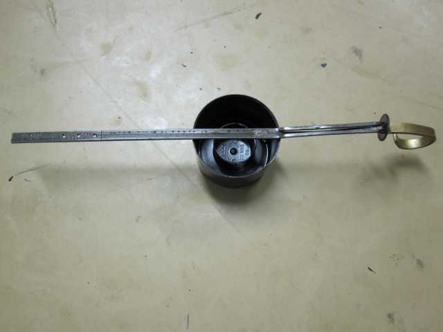

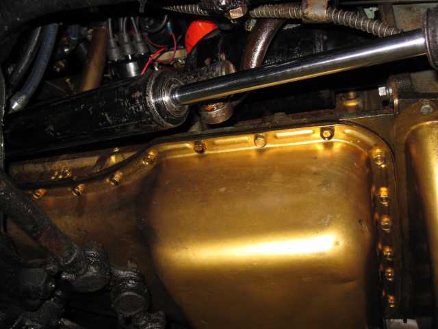

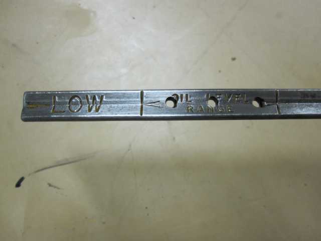

Imposing again: Put 8 qts of oil into the '53 308 w/filter change. Ran engine for circulation. The oil level on the stick is 1/4" below low mark of running range. Don't think the oil pan is larger--doesn't look modified from below {I have a lift}. So is the gage stick correct?? The distance from the stop on the stick to the bottom range mark is 9-7/8" (the level 1/4" below that). I am definitely not adding more oil until this is resolved. Unusual thing tho is that the oil level when I bought the car last week was exactly where it is now. I did not add oil since I planned to change it. Thanks in advance. Photos of bottom of stick and entire stick. EDIT: I note that a photo in the owners manual of the end of the stick does not show the 3 holes drilled in the 'Range' nor the arrows indicating lower and upper limits of 'Range'.

Oil level is between the 'W' in LOW and the lower mark(1/4" below the mark). I suspect the stick also, but the lettering is correct as per owners manual. Someone with a 'correct' stick could check the measurement from the stick stop to the low mark(the cross mark just before the word 'LOW'). Mine is 9-7/8". I won't operate until I know.

Dipstick on my '51 measures 8 5/16 from the full mark up to the underside of the "slot-holed washer" below the handle.

Tks, Park, that is the very same measurement that I have on mine. Assume that you mean the top mark as on photo above. That mark is 1-7/16" above the lower mark {which is the 'range'}. If my dipstick is correct then I would have to add almost 1-3/4" of oil to get up to the full mark at the top. That might be 2 more qts of oil that would give me almost 10 qts total that doesn't compute. Still confused. Need some others to measure their sticks !!!! I bought 3 gallons of 15W40 and now I have only one gallon left, so they went in the car???? I run that in my old cars because of the zinc. Scared to drive until I find out what is what !!

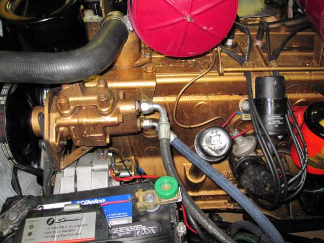

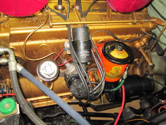

Richard, the engine number is just ahead of the front end of the exhaust manifold. Here are pic's of that area and the dipstick area on my original-engine '51.
