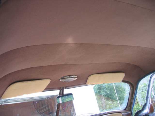

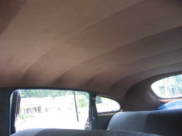

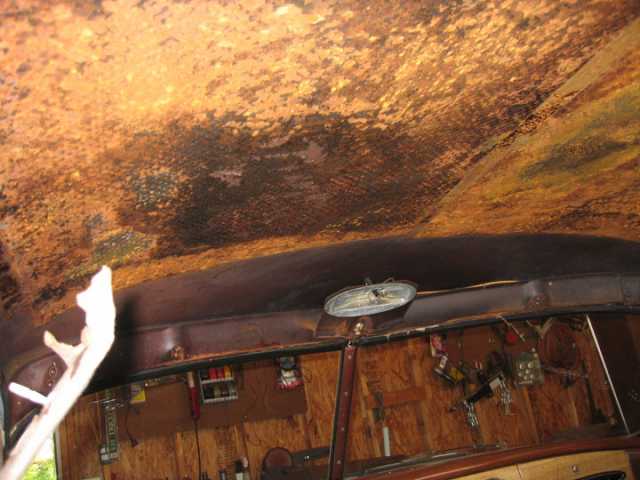

Ed, I'm trying to attach a few pics. I haven't done this on this forum yet so not sure what will happen. I took a sample of the old headliner to Hancock Fabrics and found a material that was pretty close to the same color and texture. I removed all the insulation and sanded the inside of the roof and then put all the insulation back. Richie.

That looks great! How much time did it take you to complete the job? I have a 1941 coupe that I need to replace the headliner. What equipment do you need to complete this job? A regular sewing machine? What else?

Thanks Tim, the actual installation took about a day but the prep took about a week. I went on the net and found instructions how to do the job. There is a sequence to follow, like front to back, then side to side and so on. The hardest part was going around the back window. No special tools were needed. Like I said, I did it for fun and to learn.
Doing a coupe would be a bit easier I would think. Take your time and enjoy doing it and it will come out just fine. Richie.
And yes I used a regular sewing machine. Practice sewing on scraps until you get the hang of it.
