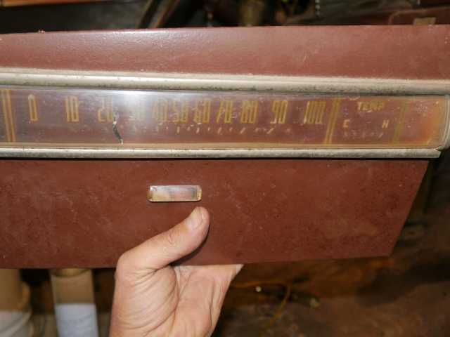

As we have worked on it, the truck is in really good shape and we are grateful for that. The speedo is destroyed from many years of sun abuse. We cannot find a replacement and are making a dash insert using a 1977 repop CJ5 speedo unit.
Anyone have a nice 1941 speedo assy?

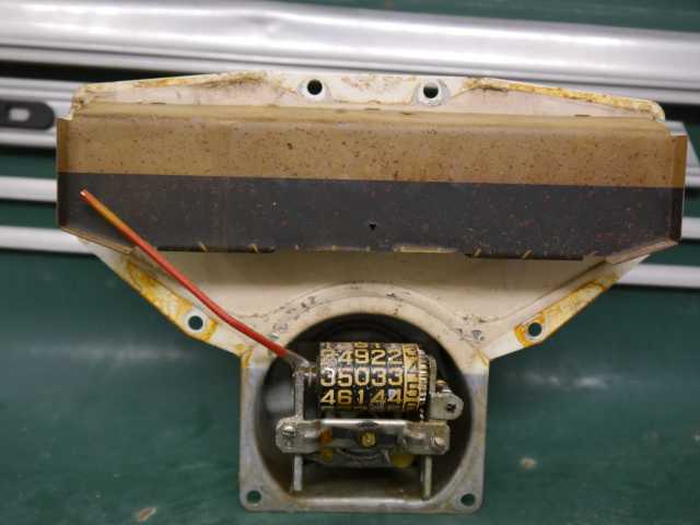

Here is what our speedo looks like. Need a replacement. Anyone have a good spare?

I'm not sure what's wrong with it. You can send these in and have them cleaned and refurbished and any broken parts can be replaced. Primarily, it will need cleaning and re-greasing after having sat for years. You can repaint the unit yourself. As far as the rest of the housing, you have to decide what the condition was originally and what you want to do. I've woodgrained these, as many were originally woodgrained. Yours could have been just a painted dash. You will have to drill out the spot welds that holds the diecast piece onto the front, then the lense and all other parts come out for cleaning, refurbishing. The plastic can probably be polished carefully and will look fine. Nothing on the face looks damaged to me -- just dirty and slightly yellowed which is oommon. Tap and put new small screws in to hold everything together once you're done cleaning. Should look nice. Besides the outer plastic lense, there are two other pieces in there.
Posted : 08/12/2013 9:09 am

that speedo lens you have is for a commodore, bigboy pickups had gold background dial artwork.
