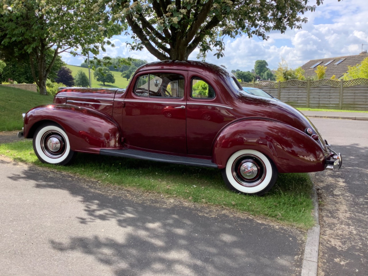

Any of you guys have any tips on safely removing the hub caps on my ‘39 Hudson Coupe without damaging the rim/cap.  Thanks
