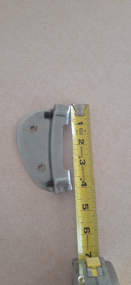

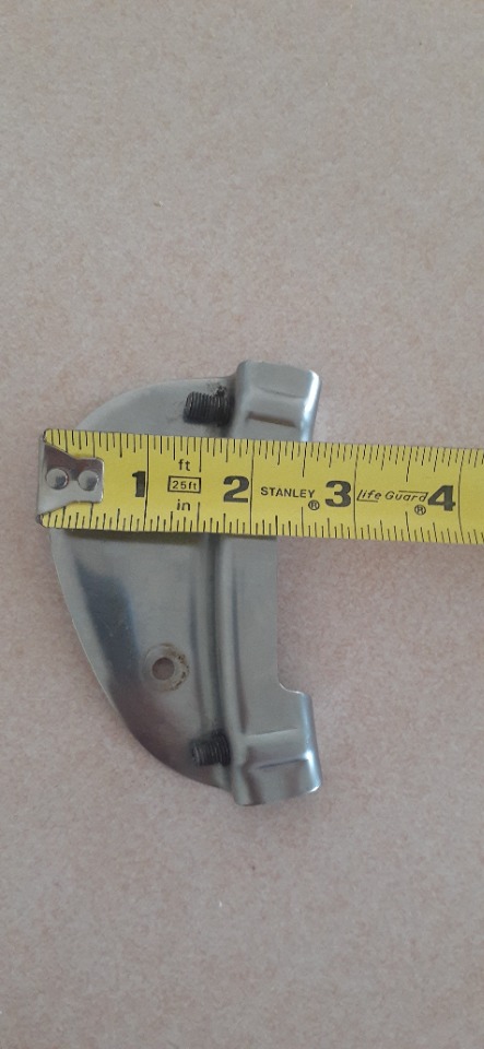

There are two part #’s for Karvisor one has smaller mounting brackets at the ends. The other one has larger side brackets and fits all step downs including Hollywood and Convertible. If you have the earlier one with the small brackets all you need is the larger end brackets. Bent Metal on here reproduces the brackets.
 Hold your visor up to your car and see if it will fit?

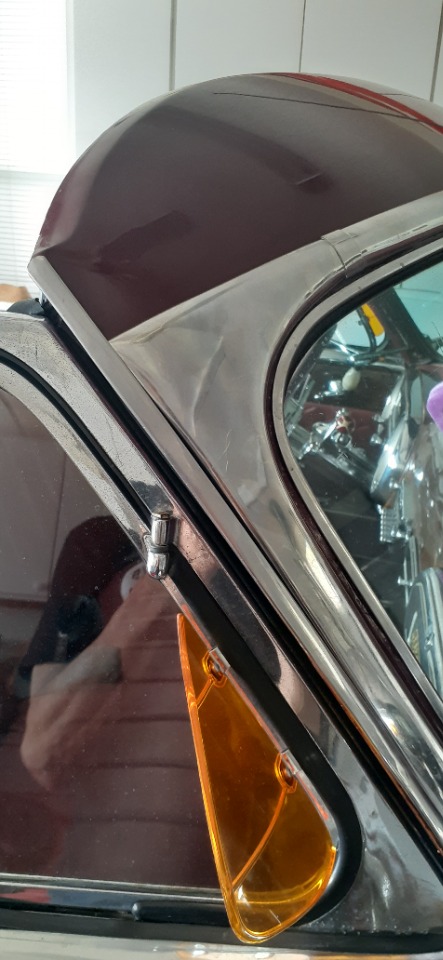

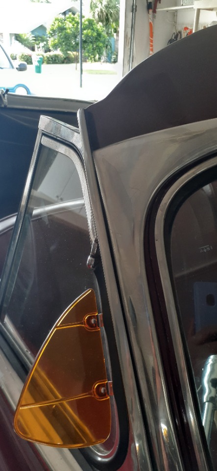

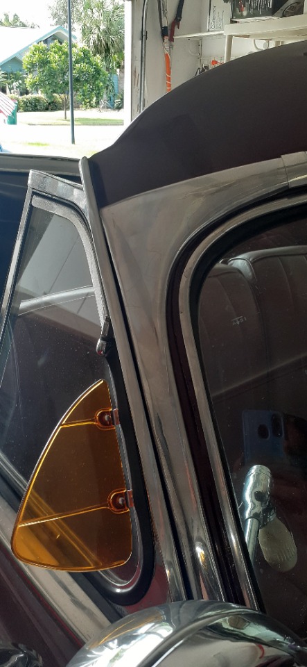

Hi Ed, as always your assistance is greatly appreciated! I wouldn't know which brackets are which. Can you tell from the pics? These brackets don't seem to fit. My other concern is once I tighten the set screws, I will scratch the bright work.

Tony:  I am remiss to have also told you that the visor mounts for the convertible and the hardtops are different.  Those mounts are nearly 1" longer than the "standard mounts".   Your can obtain the replacements from Perry Spring AKA Bent Metal as shown in the following information extracted from my website.  Call and ask Perry for a set of his brackets... they are perfect for the job.   Ken [b][email]perryscustommetal@msn.com[/email] In southern California a metal magician is plying his trade, Guy Perry II. aka [i]BENT METAL[/i] is that metal maestro. [i]He is the go to guy for Hot Rodders looking for top chops or the pickiest among us looking for concurs auto restoration metal work. [/i]He is a master at creating and installing the repair pieces you will find nowhere else. Examples of Perry's work can be found by clicking on the [url= https://forum.hetclub.org/categories/skills-mechanical-and-other-wise ]XXXX s[/url].  You can connect with Bent Metal via phone or email: Perry Spring II - [i]Perry's Custom Metal [/i]- Phone: (909) 986-6078[/b]
