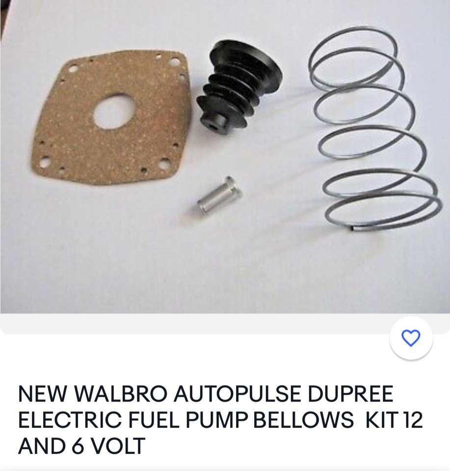

The diaphragm in those pumps are prone to tears. Operating on 12 volts a pump with a small tear may not pump on 6 volts but pump on 12 volts.  Reason : pumping plunger operates at 2x the 6 volt speed when connected to 12 volts. This may allow the pump to push some fuel in spite of a bad diaphragm.  You can find rebuild kits on line such as this eBay listing
[url= https://www.ebay.com/p/1733883967 ]www.ebay.com/p/1733883967[/url]
