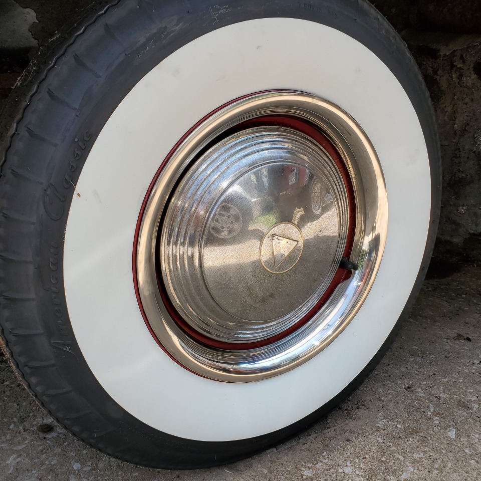

Also: got the trim rings, as suggested. What a big improvement.
