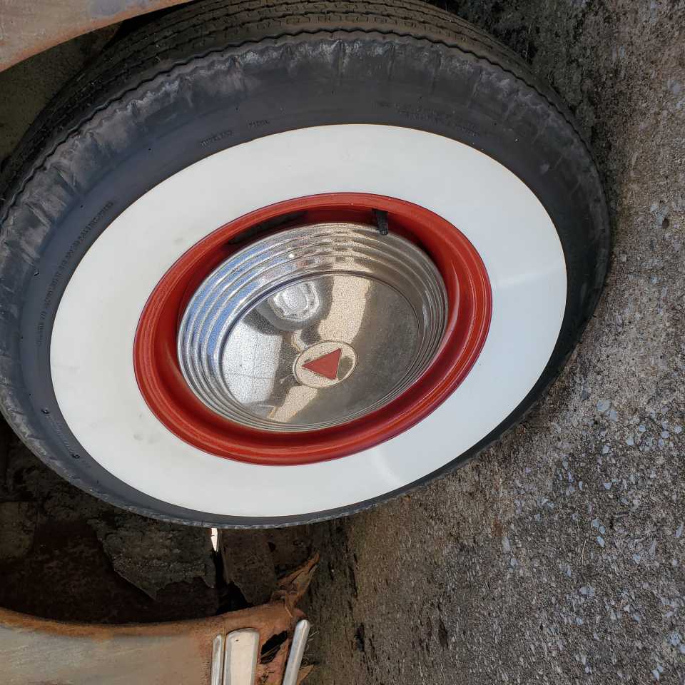

Refinished the wheels and got the new tires mounted. Wheel covers seem to be standing proud of the rim. Is that correct?

It doesn't look right to me.
Below see the same cap on '54 wheel. Notice the face of the cap DOES NOT break this wheel's outer plane. Also, the edge of the cap is held snug against the wheel.
Is your cap held on nice and tight by the retainers? Maybe the retainers are too long for this style cap.

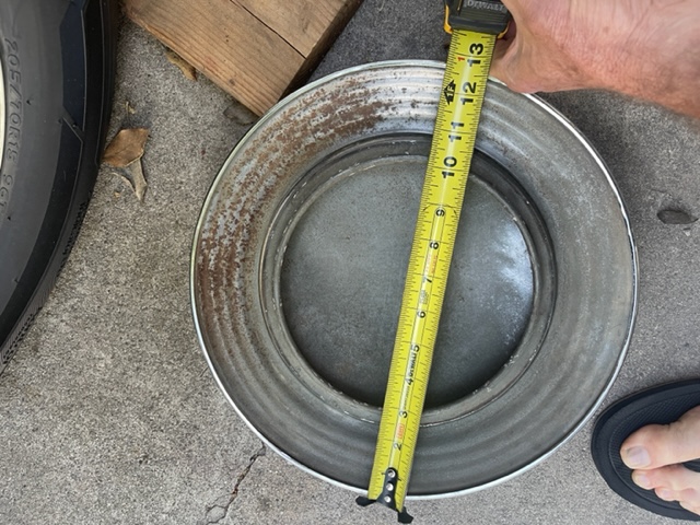

I'm no expert but think Hudson offered several versions of caps during the StepDown period. For instance I have another set of caps that are slightly smaller diameter and do not fit the wheel shown in the picture below. They are what I term a smaller dog-dish style cap. See pics below.

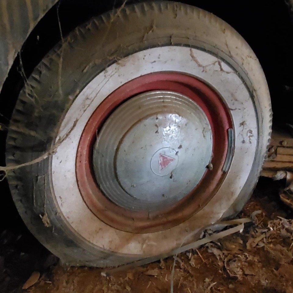

These caps were on the car when I got it. They seemed to come off pretty easily. Here is a pic while it was parked in that barn.

(@Calvin Parsons)
Looks like you have 15 inch hubcaps on 16 inch wheels. you also need trim rings to go with them

(@Darren Lee)
Those are 15in. wheels. Any idea where I could score the correct caps and rings?

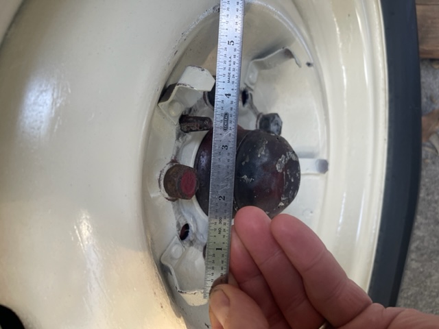

(@Robert Waid)
Darren ---Remove a cap and take a picture of the retainers. Also measure the length of the retainers and the distance between them (post this info). I'll gather the same information from my wheels/caps. I'm now second guessing my prior comment (not looking right) and maybe the caps you have are NOT the problem---the retainers might be bent or too long....

(@Darren Lee)
Good grief, I thought I was better at this than I am. Here goes again:

(@Robert Waid)
Darren ---Have a look below. If yours are wrong so are mine! They say misery loves company...I honestly thought the back of my cap sat right up against the wheel ---wrong, it actually sits approx 1/4" away. Bottomline ---I now opine your caps and wheels are fine.
