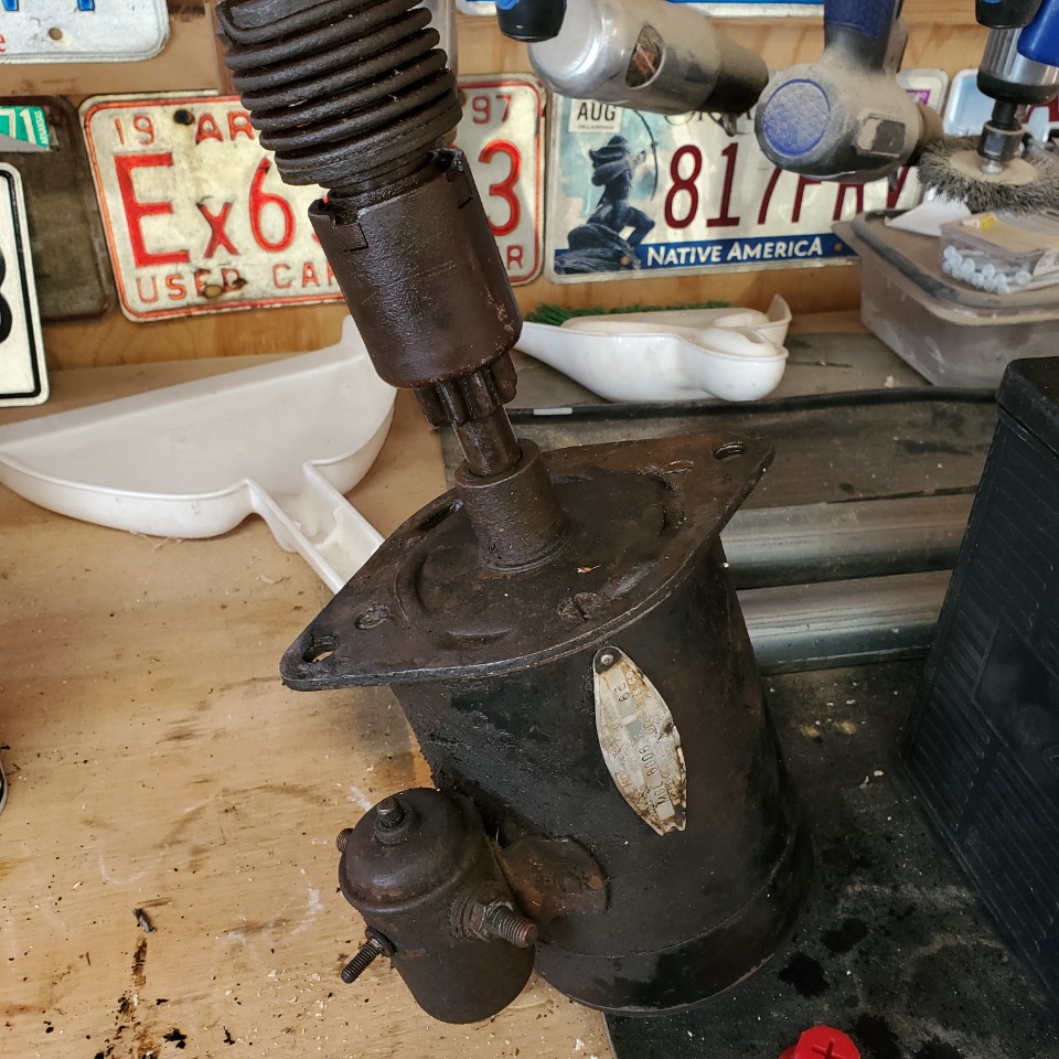

(@Darren Lee)
Finally got it out and it isn't stuck at all. Still had a lot of grit inside, but it rotates and slides. The Hudson/Delco tag is still on it as well as the distribitor and generator. Makes me think the odometer is being truthful. Probably will send it out for rebuild just to avoid a sequel.

[b][size=100]Darren
What is the number on your Hudson / Delco starter? It should be an Autolite.[/size][/b]
