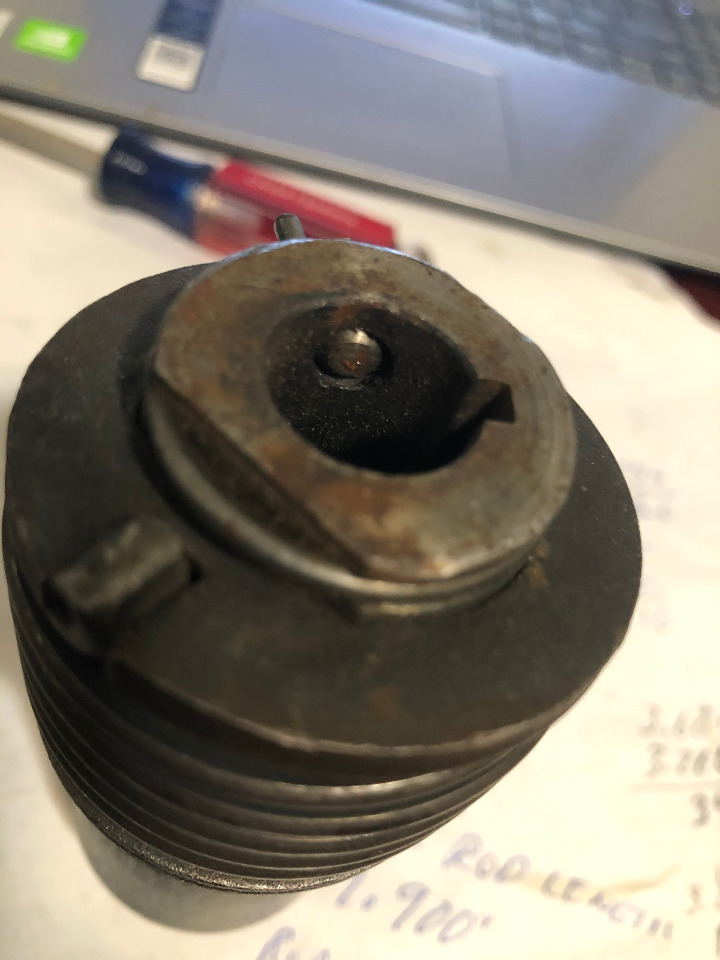

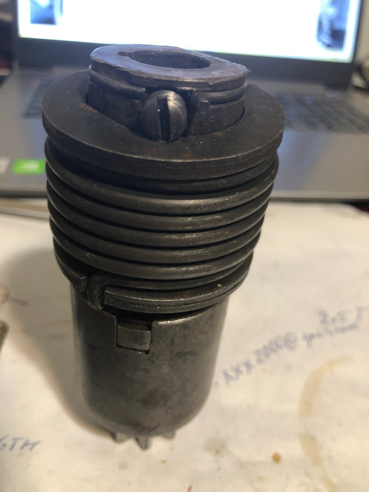

Just for the record, an inboard bendix is what one might think of as outboard (both are referenced in the 49-52 shop manual page 6-7), since it lives outside the starter motor. You may then be as confused as I have been the past few days.
Inboard seems to mean that the bendix and spring assembly is IN LINE with the center axis of the starter and can, presumably, be removed with the starter in situ by removing a snap ring. I am at work today so will not be able to verify until the weekend. Someone here on the site mentioned that it could be removed by driving out a pin, but I now believe that he was referring to the outboard bendix that was used with the GM sourced automatic transmission.
If I have that wrong, please feel free to correct the record.
Posted : 06/04/2022 8:51 am

You do NOT remove the snap ring.....all that snap ring does is hold the big thick washer and the spring ahead of it on. What you DO, is push hard on that washer, push it forward until the set screw, or in some cases a pin, that holds the whole Bendix assembly onto the starter motor shaft, is exposed. If it is a set screw, you unscrew it until the screw is out of the shaft, and then you can use a small puller to pull the Bendix assembly off the shaft. Reason I say to use a small puller is that after 70 years of being in a dirt floored barn, there IS going to be some rust holding it to the shaft. You are going to need to spray the thing liberally in a good penetrating oil. PB Blaster works, given some time. Better would be Kano Labs Kroil in the spray can. WD-40 won't cut the mustard. In the case there is a pin holding the Bendix on and mot a set screw, you need a 1/4" punch to punch it out, tapping the punch with a hammer. You could compress the spring with a couple of 2-1/2" long bolts on each side using flat washers as hooks on the front and back of the spring , and nuts. Tighten the nuts evenly on each side until the washer is far forward enough to expose the set screw or pin. Once the Bendix is off, then you can try working the Bendix forward and back on the scroll. Might use the cheaper PB Blaster and brake cleaner to flush all the rust and dirt out. When the PB Blaster is not longer running  out dirty and black, spray it good with the brake cleaner until that runs clear. The Bendix gear should be moving forward and back freely. Do not use oil or grease on it before putting it back on,, as this usually just traps dirt and it will stick again.
