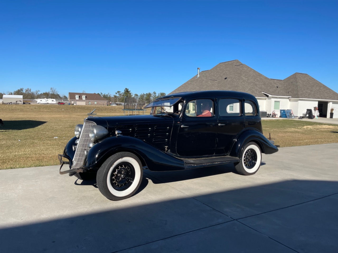

I got a message asking if I would post pics…well of course!
Anyone know where I can get the materials to replace the fabric roof insert? Once I get that part fixed, I want to replace the window seals, and remove door panels and clean/lubricate the rails etc to make rolling windows up and down easier.
anyone have any advice or know of anyone around Louisiana or SETX that could help with the roof insert? I wanna do my best to keep things right and correct. I’m only 33 and wanna see my kids be able to enjoy it one day!

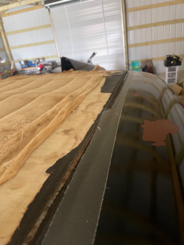

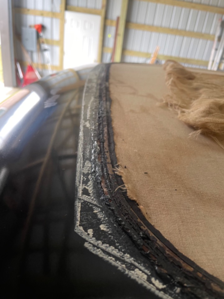

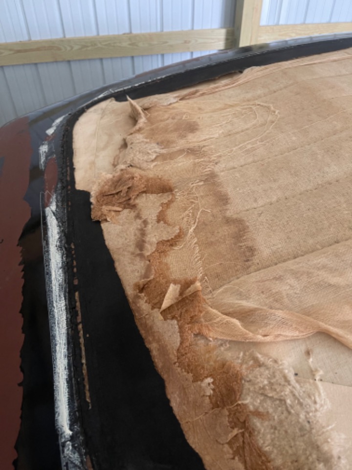

(@Jacob Fox)

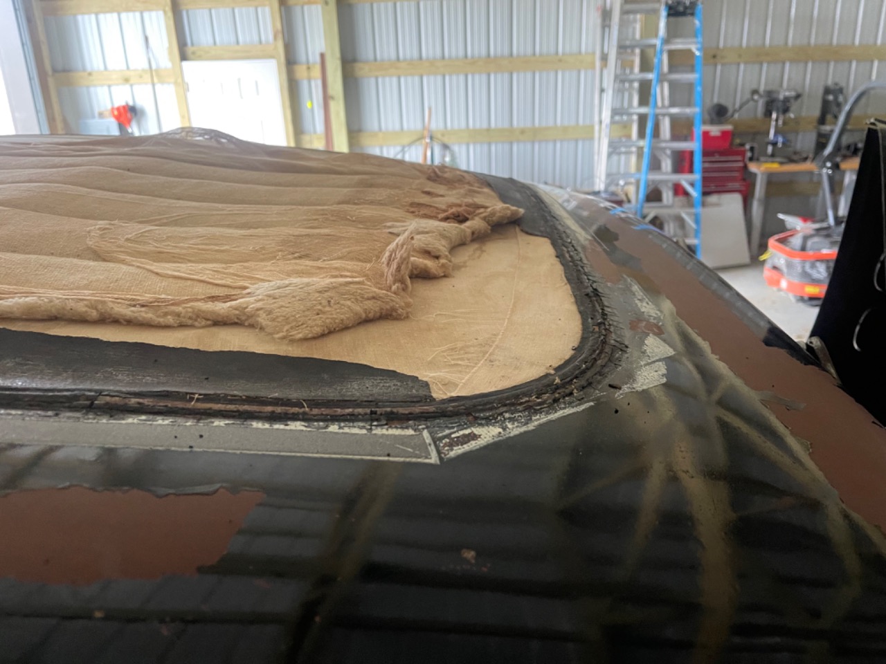

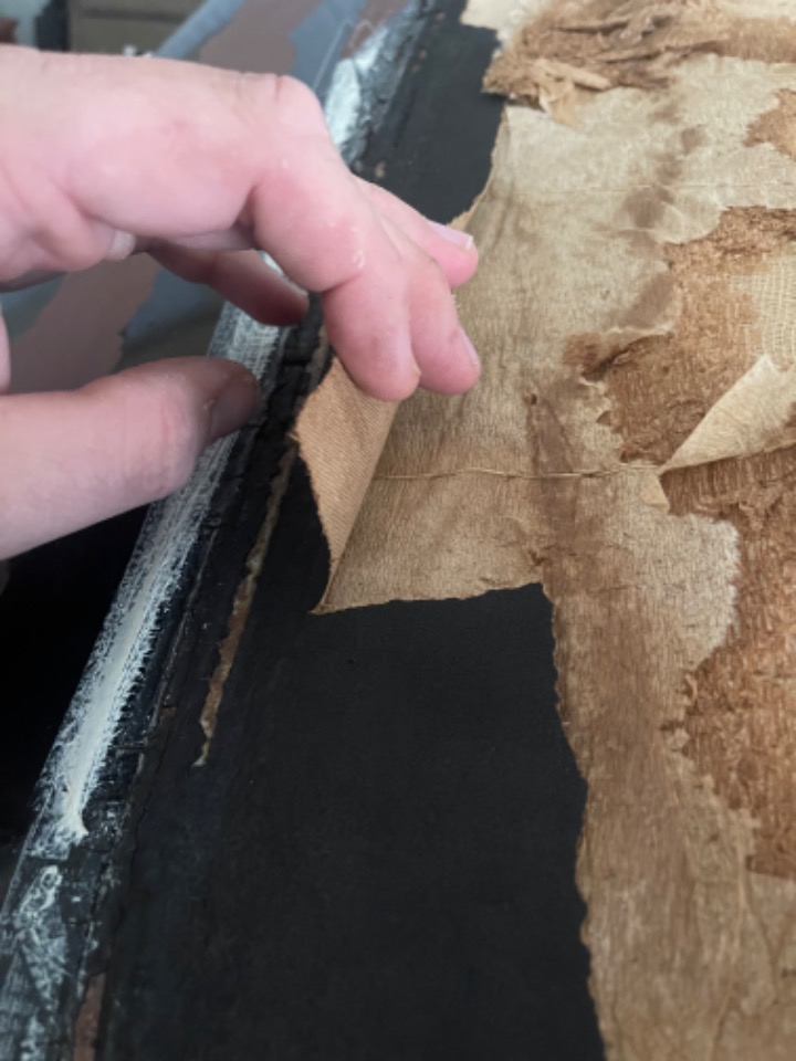

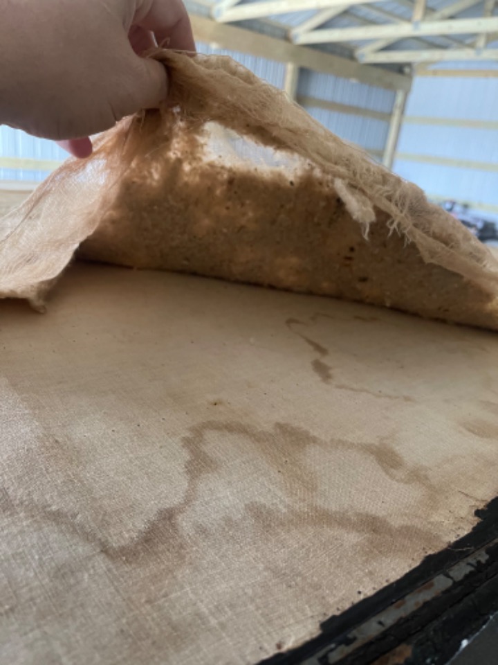

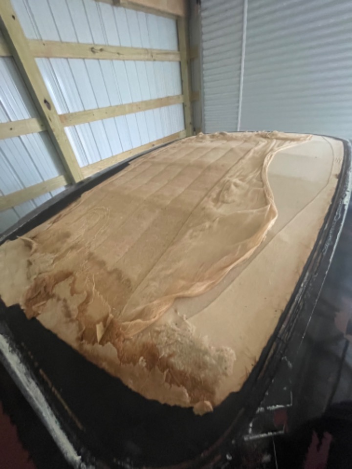

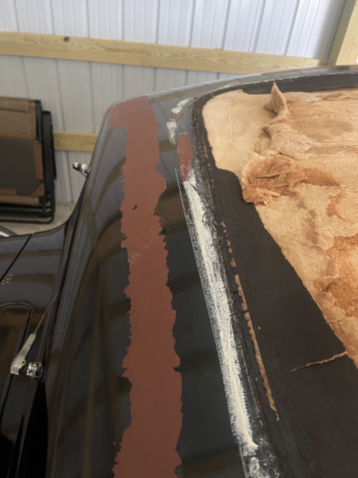

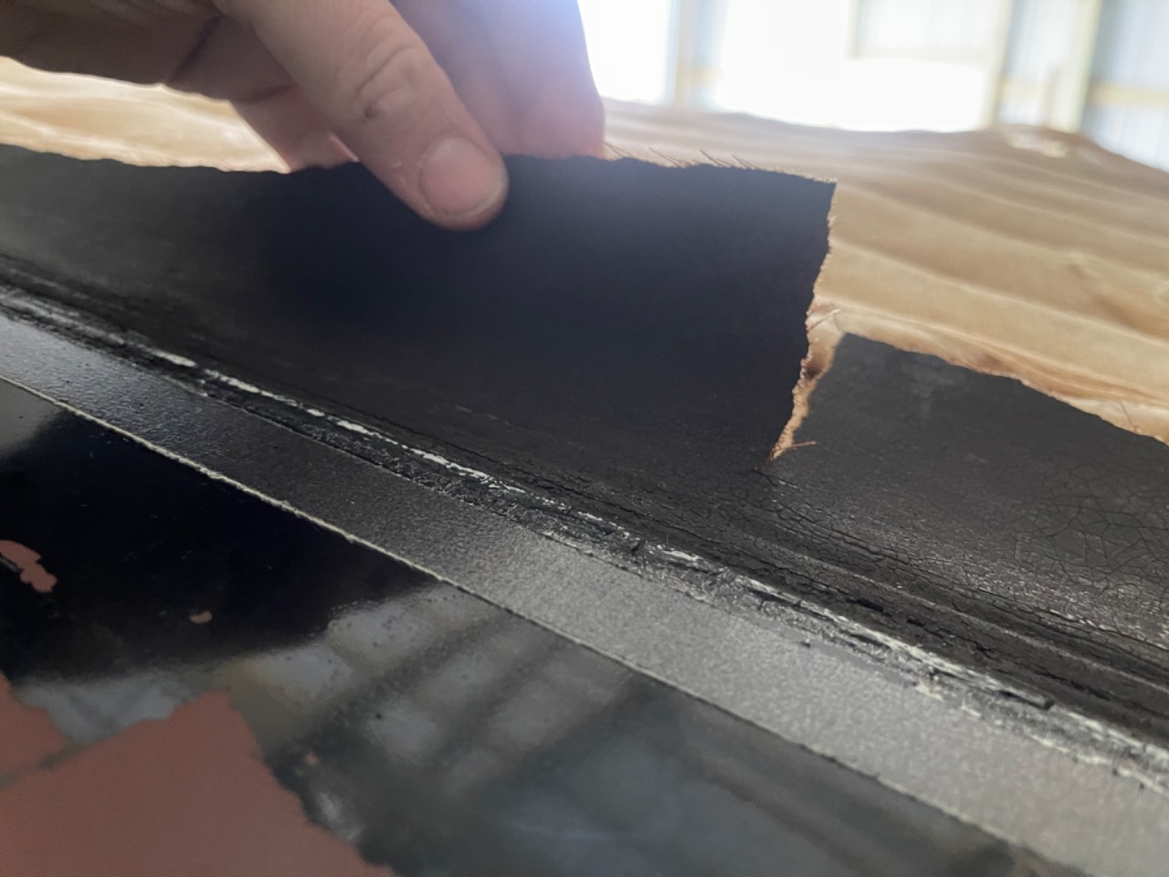

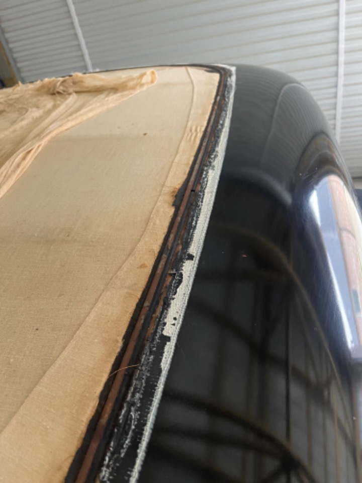

This is copied and pasted here from Open forum so I can keep this thread updated as well. May make another thread:
I hope I didn’t bite off more than I can chew. I’ll admit when I got that tarp off I felt a little overwhelmed never having done this before. Fortunately goo-gone helped with not removing more of the paint from the tape. I’ll see if I can get the roof sanded and painted back to look like the rest if possible after roof done cause the primer is very very good underneath. Maybe I can find someone that can lightly sand and get the peeling paint back a bit then just shoot those spots.
Anyways, here is some pics of what I found. I find it scary but also fascinating lol. So you can see the different original layers which is cool. Bottom Muslin fabric, then a cotton padding, then what looks like another muslin fabric then the black “canvas” roof material. Boy is vinyl gonna be an upgrade! If anyone knows someone around SWLA or SETX that could come assist and give advice, I wouldn’t mind paying their way and paying for their time…and their beer! Lol I’m just afraid ima mess something up. Can’t really afford to make a big mistake lol

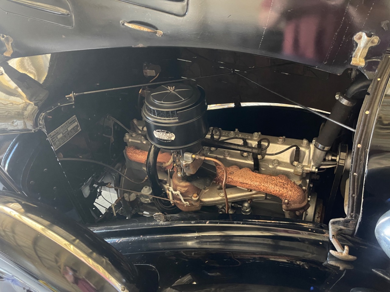

One other thing, how can I keep humidity down in a shop? I have a 30x40 shop, with 2 roll up doors in the front and 1 in back, and I just feel like ima have humidity rusting issues with this stupid Louisiana weather. For instance my oil tell-tell has always worked, today, it worked then went out before I even started it lol But boy did Doug at Wildrick do a good job putting thing thing together cause it’s been sitting 6 days and got down to 26, today is in 40s…got in…and it fired right up  [img] [/img] . I do need to figure out how to keep my leaf springs from getting surface rust between each leaf, the antifreeze that got on it the other day is making it nasty. The pretty black paint has orange in between. I wiped it down and sprayed with some oil hoping to repel.
OH and i ran it for prolly 5 min, and no antifreeze out the water pump…so I guess it was just the fact it had too much and no where to go. Will have to see once I can drive it again.
Posted : 25/01/2022 4:16 am

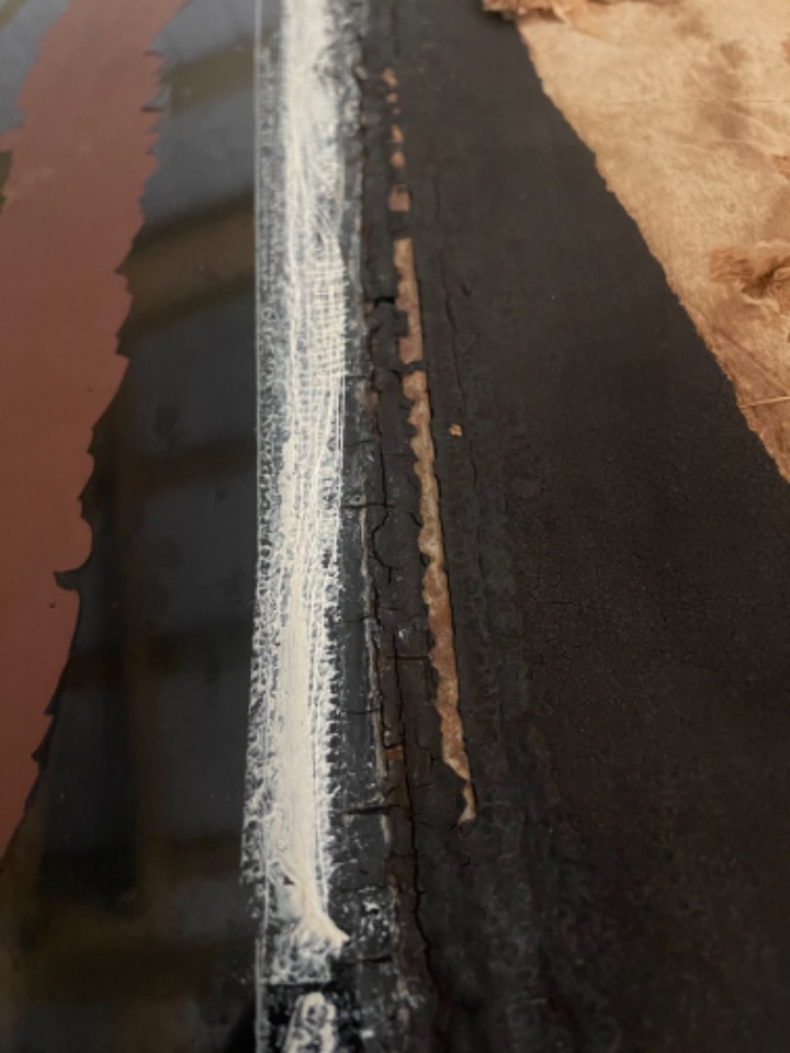

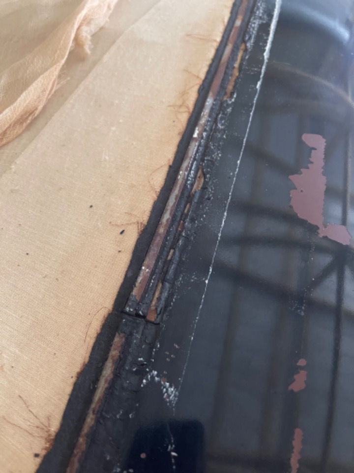

Few more:

(@dlm31)
Posts: 960
Noble Member Registered
Jacob, before you get too carried away, go buy some surface prep. There are several different brands, I think NAPAS name brand is Kleez-EZ. It will remove the tape adhesive and not the finish. After you have it cleaned , you will be able to see the groove that originally had the rubber inserted into it. Once the top material was installed, tacked and sealed, the rubber gets installed into the groove for the final transition to the body. Hope this info helps you, as to the more information you get here, the less likely to make you confused and/or afraid to continue, you got this!

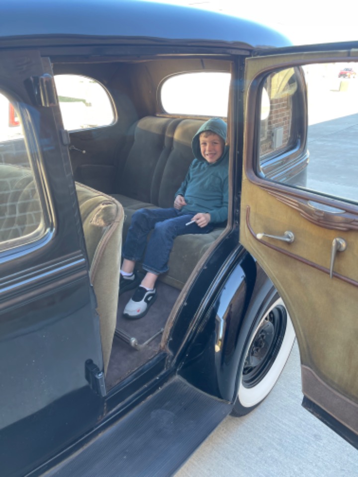

(@Jacob Fox)
I’ve been posting more on the open forum as it seems to get more traffic, but I figured I’d ask here, anyone know how to remove the rear seat in a 34’ Deluxe? I don’t wanna pull on something and break something I’ll regret lol need to put seatbelts in for the kiddos
Posted : 28/01/2022 10:45 am
(@dlm31)
Posts: 960
Jacob, push in and lift upwards.
