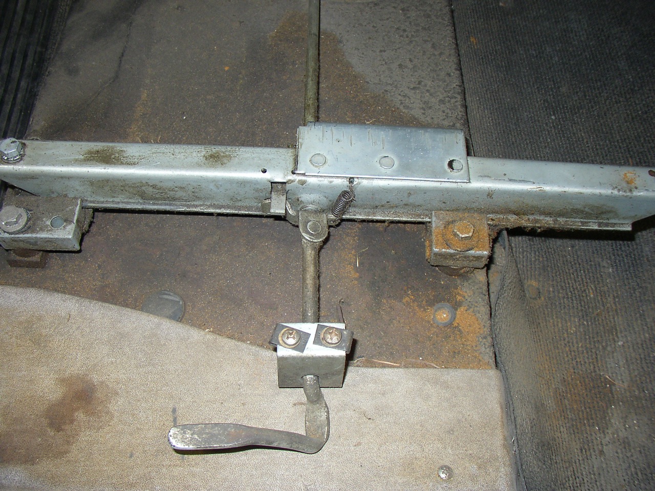

Here is a photo of the adjuster and the elusive spring in my 1950 Pacemaker.  Hope this helps.

   OK, now that I see the photo, I understand why I was having problems. The rectangular piece toward the end of the handle is missing on mine. I believe that the piece attaches to the seat tray and not the vehicle floor and if it is solid or hollow. If the assumption is wrong, please advise. If anyone might know where to get one, please advise. Thank you all for your help.

(@hudbob)
Posts: 117
Estimable Member Registered
Ron,
The two Phillips head screws go through the seat pan that's what holds everything in place.  The release bracket does not attach to the floor, everything moves with the seat.

         Thank you. Now I know why nothing was making sense. I don't know if the part I have is for another vehicle or has parts missing. I'll have to try to locate one or try and make something that will work.

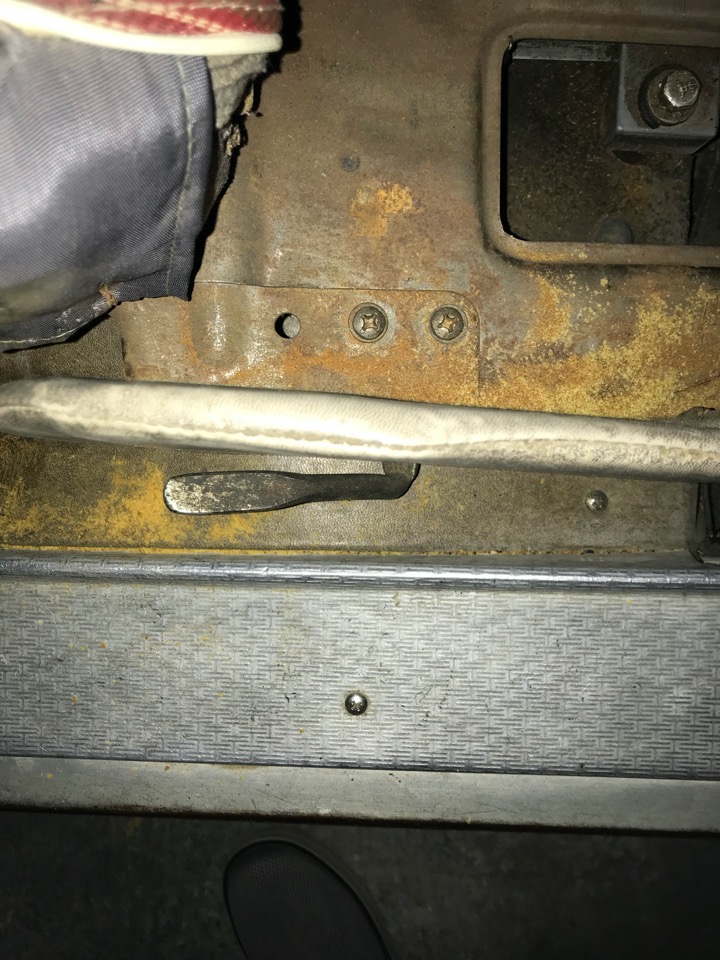

   Thank you. I attached a photo of the part I was trying to use.

Looks like the original handle was broken off the shaft and they attached a handle from something else using a countersink screw......
