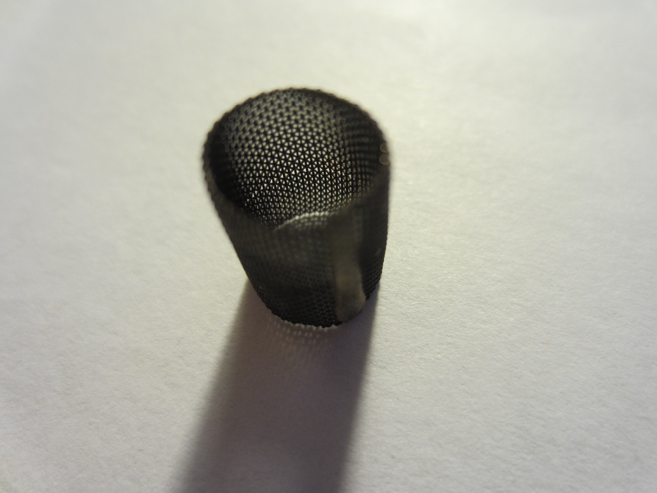

I have one out of another 311S that measures 0.3125 OD x 0.4075 LG X 0.012 thick.
See attached pics.
If anyone has a strainer this size OR a carb of 35-37 vintage with this size strainer I'd be interested in purchasing it.

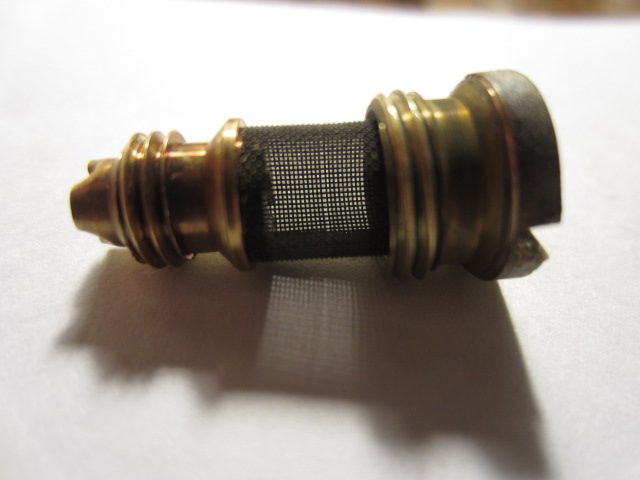

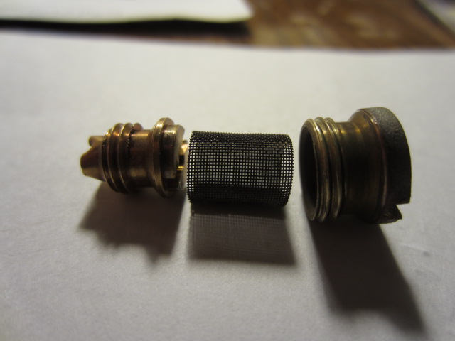

Heres pics of the check valve, screen & plug cap.  The screen fits snug on the shoulder of the valve & snug in the bore of the plug cap.  Kinda like it grew there.
