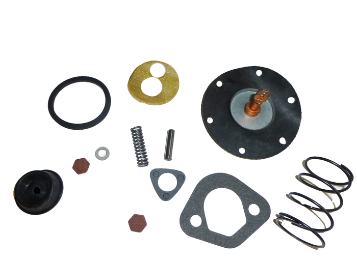

(@Bill Johnson)
Comparison of the 1941 To 1948 Ford flathead diaphragm to the old AC type 459 single. The parts are very similar. The main difference is the bottom washer holding the diaphragm. The Ford is approx 1/2 inch larger diameter than the AC. This diaphragm assy fits into the old AC pump housing. I;m not sure if this difference will have much effect on the action of the pump ??
See attached comparison picture.
Posted : 08/06/2021 11:22 am
(@adamb)
Posts: 320
The small difference in the bottom washer size makes no difference in pressure or flow, only the  changing the spring tension on the big spring that seats in the top washer would change the pressure. Should be just fine. Go ahead and put it together and test it out and report back.  K
