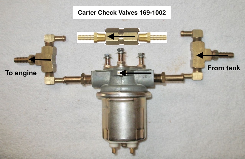

If you use a rotary pump it is simple enough to plumb in a bypass with a check valve.  The Carter rotary pumps are very durable.
