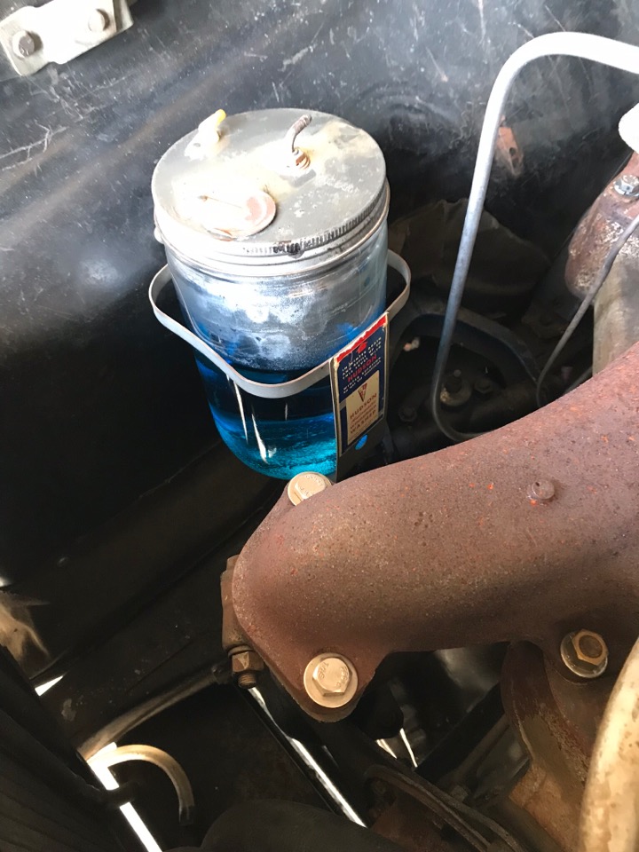

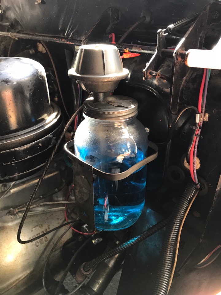

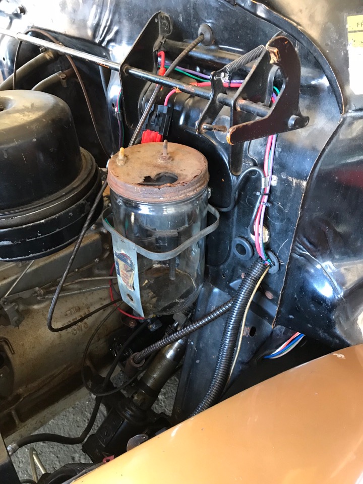

(@dafast)
Posts: 352
Honorable Member Registered
On the 51’s the washer bottle mounts on the right hand inner fender, there are two dimples where to drill the mounting holes. On the 46-47 the washer bottle mount don the left side firewall. I’ll try and post photos.

(@Robert Waid)
Thanks for the pics! Goes to show you still can learn something new. Funny enough many moons ago I found one of these large "peanut butter" jars tossed in a Hudson trunk but didn't realize what I was looking at and threw it away. Never do that again. Thanks for the help gents.
