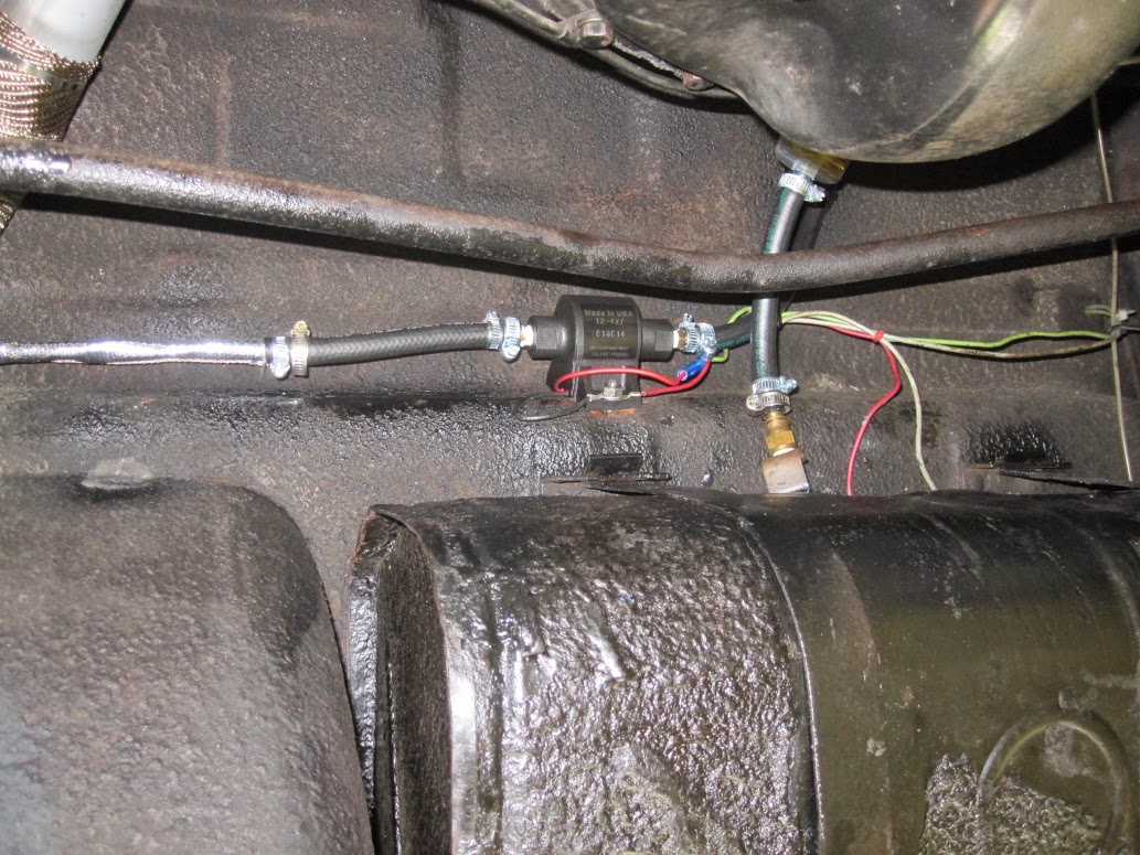

does anyone know of a rotary type 12 volt electric fuel pump that is quiet? I have one of the small Airtex rotary pumps that is so loud I even tried mounting it with rubber and it sounds like an air chisel.

Carter has one, I've bought a couple thru Summit Racing.

I'm using the Carter ones from Summit Racing on three of my Hudsons, all mounted with the supplied rubber isolators. They make noise, but I can't hear them when the engine is running.

I am using the P4594.Carter

Carter Universal Rotary Vane Electric Fuel Pumps P4594
5 to 9 psi rating. I still install a fuel pressure regulator. I've used these on several studebakers with no issues.

Thanks for all of the replies. My question was about noise, not the benefits or drawbacks of an electric pump. I have electric pumps on others cars. And cars with both pumps installed. Both 6 and 12 volt electric pumps are available with various pressure out puts. My 46 8cyl. Came with an electric pump and bad wiring. When I converted it to 12 volts I had to change the pump. The noise on this one is just to loud. I’m going to switch to the Carter P4594. Thank you everyone that answered.

I installed a new carter pump and it is nice an quiet now.
