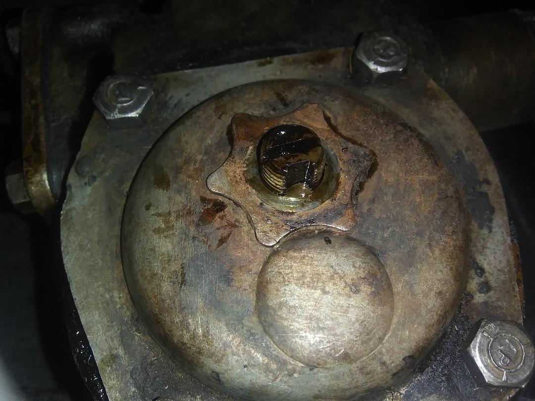

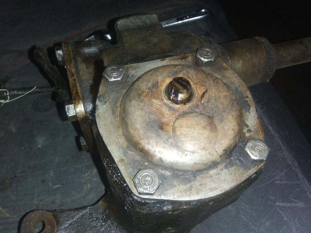

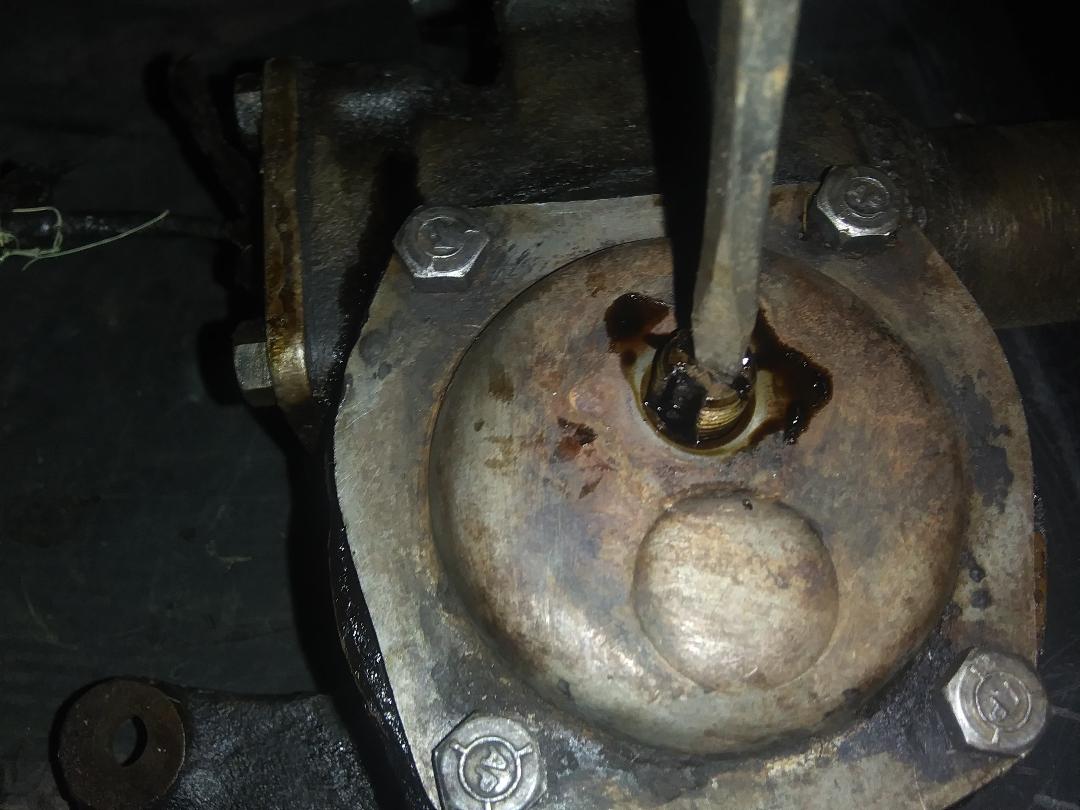

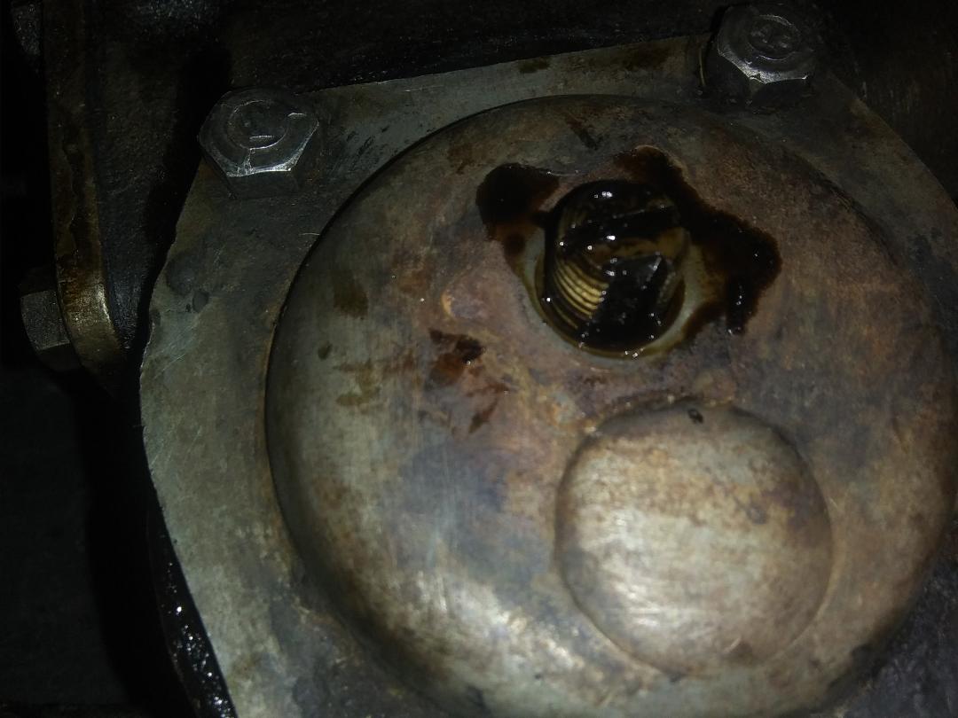

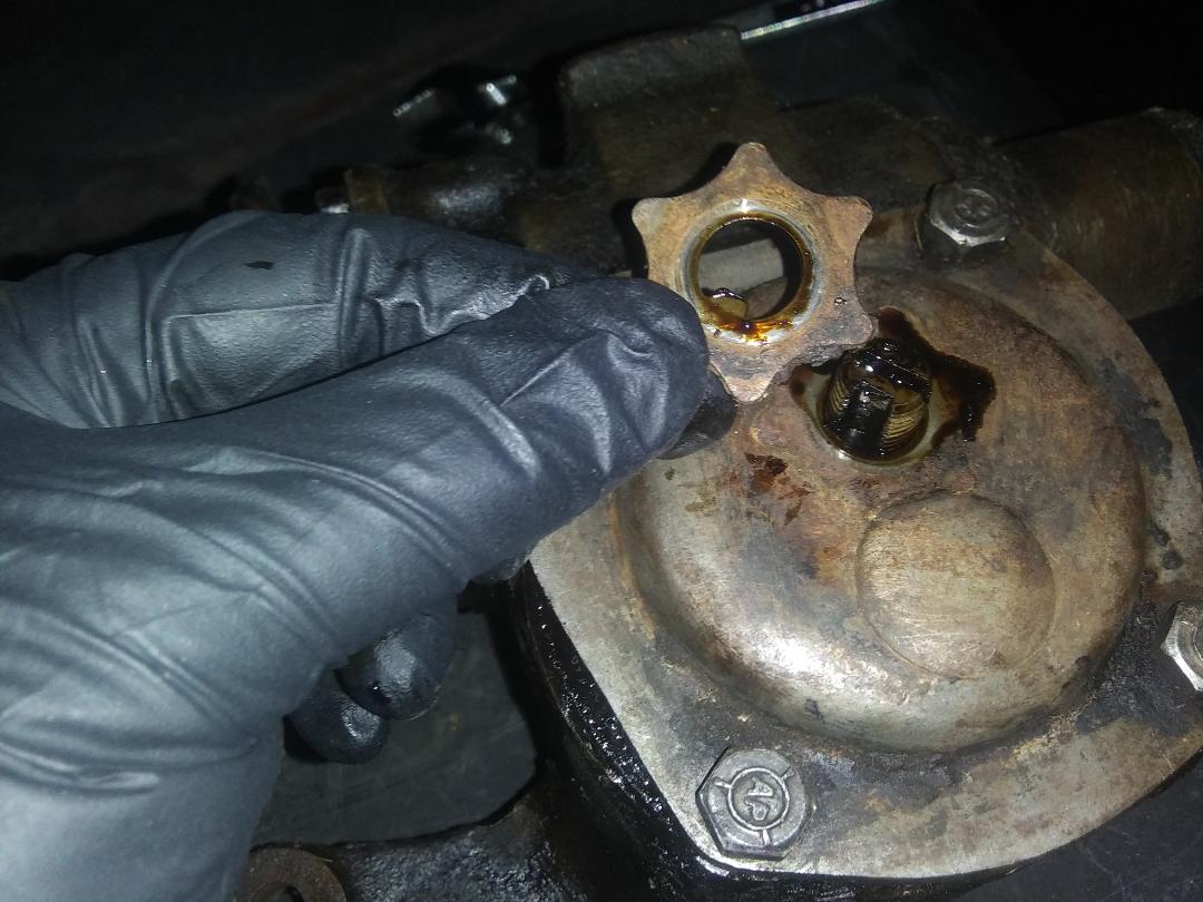

Yes, remove the cap from the adjuster, take off the lock washer and try turning the screw out. It could be that the mesh is too tight. You need to have the pitman arm on so you can detect the looseness. Set the box in the position of least play and turn the adjustment out until you can feel discernible movement of the pitman arm, and then turn It back until there is no movement, and see how it feels as you go right through the left and right positions. Good luck,
