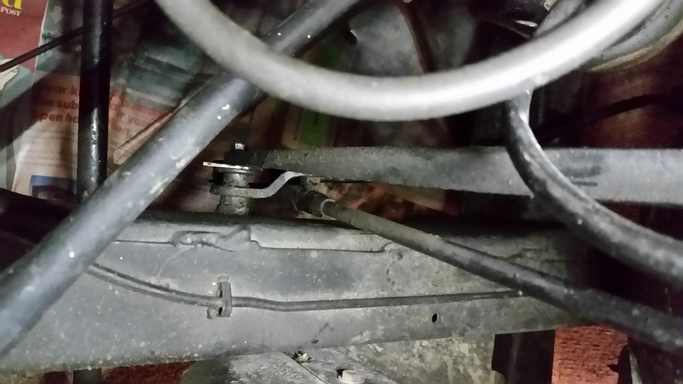

This is a 50 which may be different but hopefully will help you.
Posted : 20/09/2020 8:35 am
(@Geoff Williamson)
Thanks Alistair - that looks like it bolts directly to the firewall with a flat steel bar that braces the mounting bolt running down to the inside of a front frame rail perhaps.

Looks like I found the reinforced plate that linkage pivot bolts onto - and I now have it all secure and changing gears, at least forward gears!
The reverse gear thing appears to be a cable operated jobbie, which will need a damn good clean up and then finding the part that goes into the side of the gearbox....

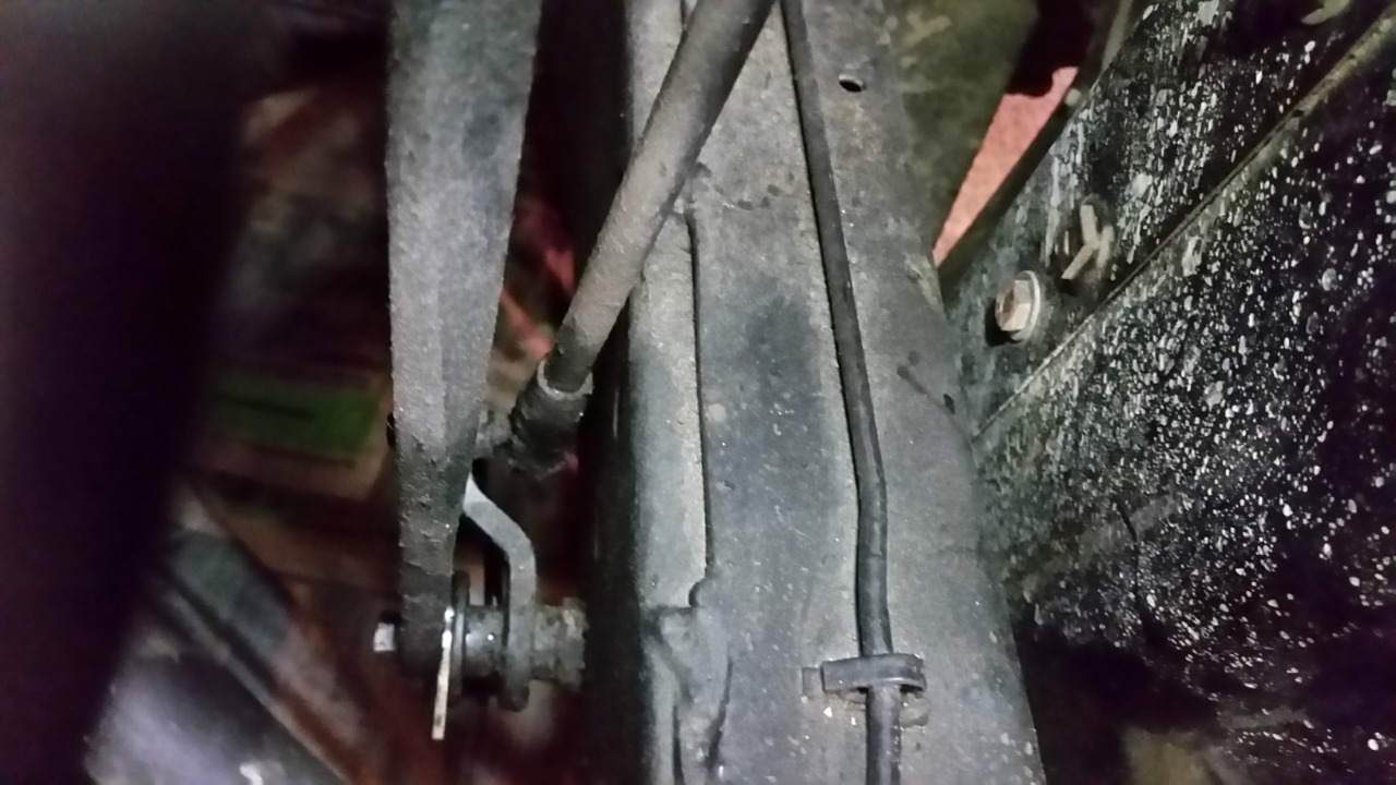

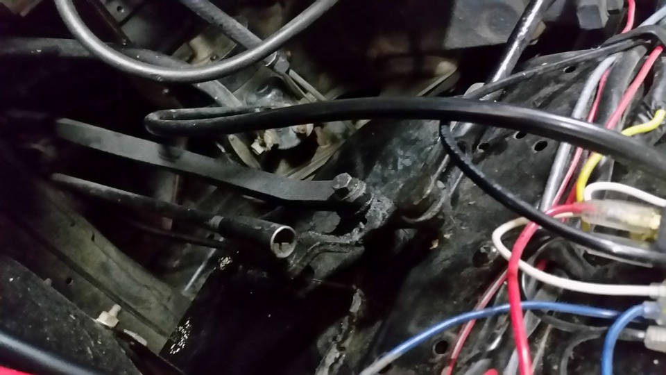

(@mikew16165)
Posts: 210
Another couple of the lower linkage.
Posted : 20/09/2020 7:07 pm
(@Geoff Williamson)
Thanks again Alistair - I see the logic of the flat bar now, stabilises and therefore takes the flex out of that section of the linkage. Looks like they dropped that idea in the Australian-delivered '51 models like mine in favour of a ribbed plate for the top pivot. Not sure it's an improvement however!
