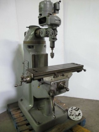

If you intend to drill those holes in the head, you MUST do this on a BRIDGEPORT type mill. That is the only way to locate the holes accurately and get the drill perpendicular to the head. Attempting to hand drill those hole with a hand drill is asking for trouble and possibly personal injury. I clamped the head on top of parallel blocks on the mill table so it couldn't move.
