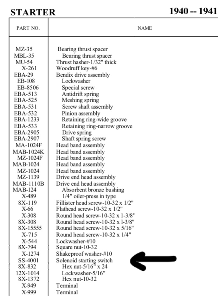

The parts book for the car shows the following pictures and the part number for the solenoid.

Jon is correct
1934 1939, 1941 - 1950 SS 4001 = Echlin ST 63. = 6v Grounded Base, Curved Bracket
1940 The solenoid on EBay = Tungsten SS301 = AL SS 4004 = Echlin ST 55 = 6v, Insulated base, curved bracket.
This means that if your car starts you have the correct solenoid. You could have the wrong starter installed. If you have the correct starter, then you have the correct solenoid so you have to adjust the linkage.
Good Luck.

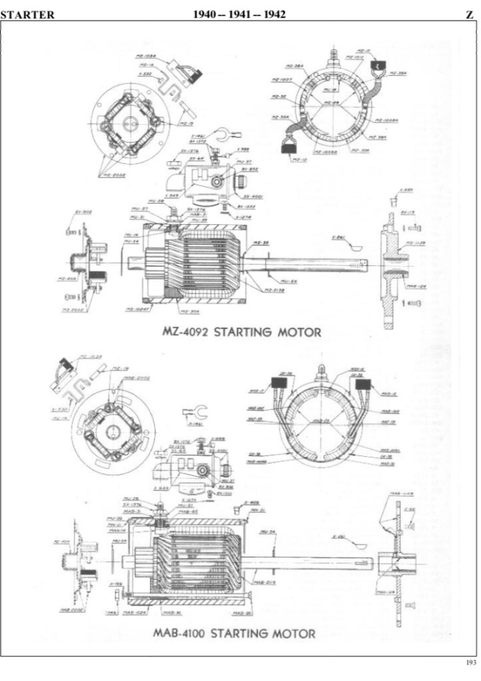

Here is something fairlly strange.
Ken Cates' page from the parts book for 1940-41-42, shows the AutoLite starter numbers as either MAB4100 (for the 8-cyl., one assumes), and MZ-4092 (for the six). Hudson's 1941 parts book duplicates these same starters as one would expect.
But Hudson's parts book for 1940, shows two completely different starters: MZ-4079 and MAB-4103. In fact, they should be shown just as Ken has shown then, MZ-4092 and MAB 4100. This is very weird.
