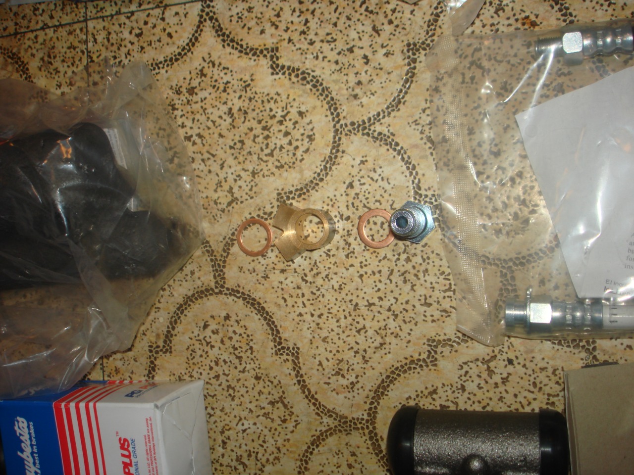

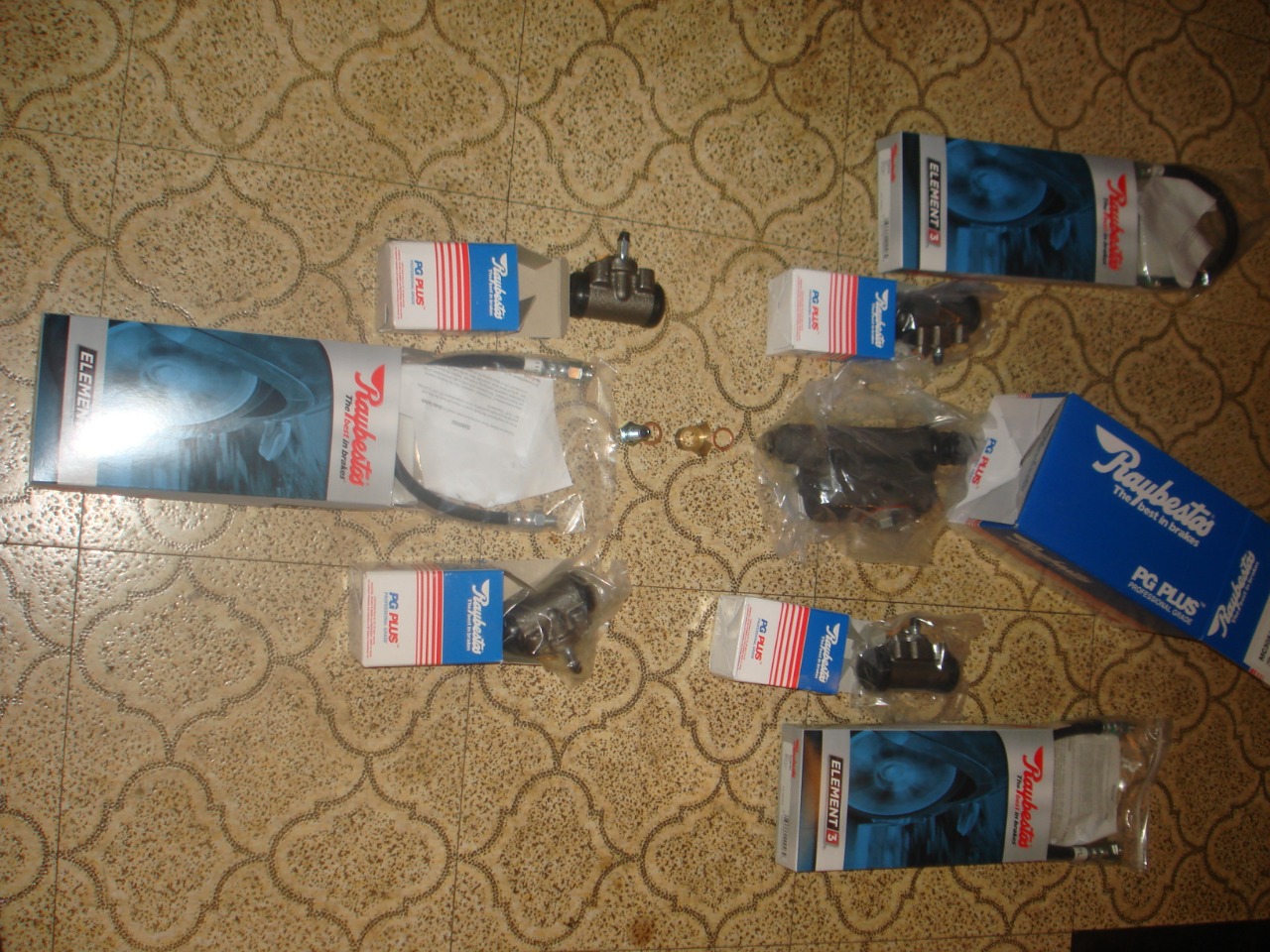

I have a complete set of the hydraulic brake parts for a LWB Stepdown, including new banjo bolt, copper washers and the brass Y outlet. $230 + Shipping. This is an extra set I bought when I FORGOT I already had a set on hand, LOL.
Posted : 18/03/2020 7:45 pm
(@Robert Waid)
Hello Kenneth ---I completely rebuilt the brakes on a 53' Hollywood a couple of months ago including replacing every part shown in your pictures EXCEPT the "Y" outlet and banjo bolt. Do you know the individual part number(s) and supplier information for the "Y" and banjo bolt? Also, if you are open to parting the kit I'd buy these two sub-parts. Please advise, Thank you
Posted : 28/03/2020 3:01 am
(@adamb)
Posts: 320
Robert, sent you an email reply. Regards, Kenneth
