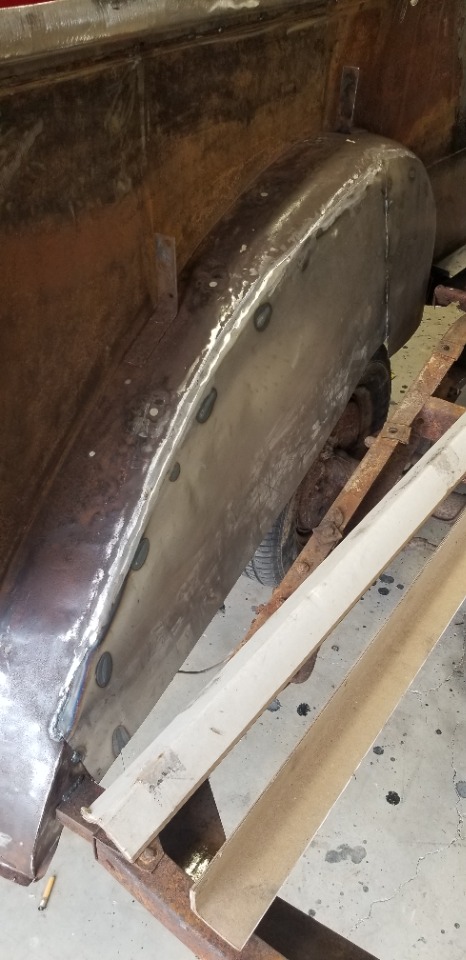

David,Here are a few pics of the bed area and cab of my 36 for you!

(@David Smallacombe)
Hi Kevin,
I see what you mean! At least it has saved some time removing the old stuff [img]/media/kunena/emoticons/tongue.png[/img].
Nice start with the wheel arches.
