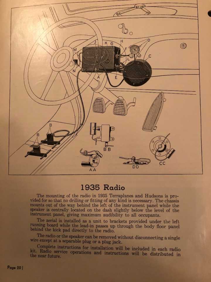

Are there any detailed pictures how the factory radio mounts in a '35 ? . The shop manual shows a diagram and references brackets that are used to hold the radio to the steering column but I do not see what the brackets look like .

There’s a brace under the dash at the steering column. The radio electronics box mounts on top. Two studs in the radio chassis secure it to this brace. The separate speaker housing mounts to the inner firewall.
The antenna, at least on mine car (34 Terraplane) is the chicken wire in the soft roof panel

Thanks for the reply. My 35 has the brace and looks as if the radio just bolts in place.My radio is missing the drive cables which I think I can make. It does not have the nuts ( which appear to be a pipe thread ) which tighten to hold the drive cables in place. If your radio has these, I would appreciate a picture of just the nuts to see what they look like. Are they just hex nuts, round ones, etc.

On 1935 cars the aerial was strung beneath the left hand running board.
