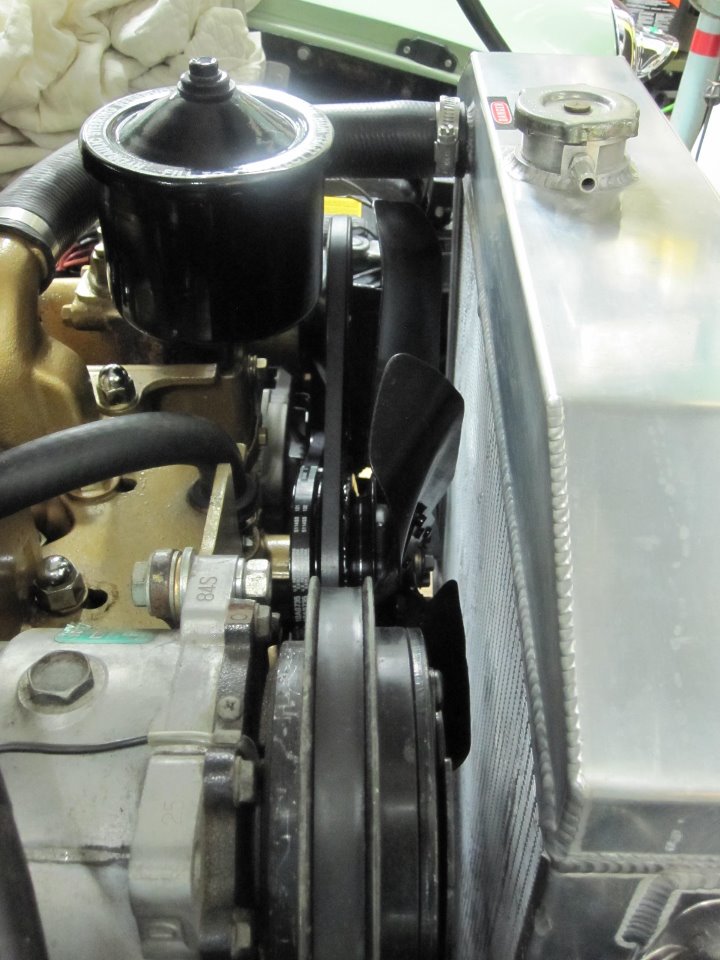

Now in the same boat. Shut the car off and streams of coolant started shooting out of the core. "Stop-leak" didn't help. The core is shot and I am trying to decide between attempting to re-core or BTR. This is why I try to keep an updated spreadsheet of compatible parts for my '51.

(@Christopher Chancellor)
Good to know! I cleaned up my list, only excluding what you mentioned since there is no point in repeating on the same thread.
Ken Ufheil appears to recommend the Brice Thomas Radiator. I have found his recommendations have worked really well in the desert climate of SE NM (such as the Royal Purple 75W-140 gear oil for the transmission and differential). I contacted BTR and discovered that their model is a drop-in replacement, and not only can they paint the aluminum radiator black, but are also willing to replicate the long overflow tube. Total price shipped, with the modifications, is about $600. I am trying to keep the engine bay original in appearance (even when I cheat a bit with the straight-8 air cleaner and "tweaked" '54 fan). I gave up trying to find a cover I liked for the battery.
