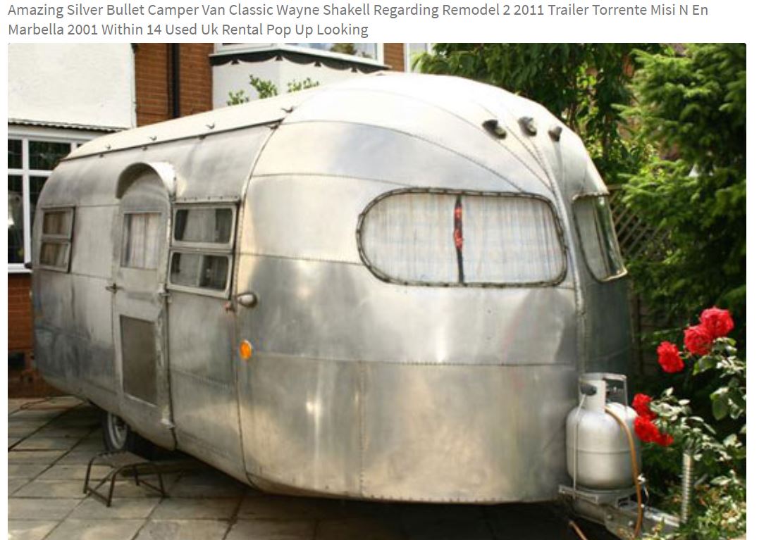

(@Ryan Pope)
Tell me.
Note see attached photo because I am going to build a complete nosed front without windows but with a cargo door low and over the tongue
Posted : 04/06/2019 2:04 pm
