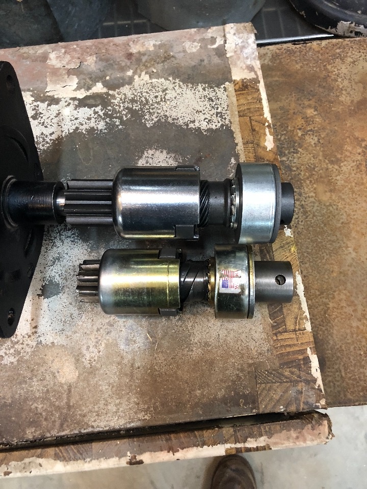

(@Jeff Adcock)
Hear is a photo of the starter

(@Jeff Adcock)
Here are photos
Posted : 09/08/2018 3:34 am
(@Lance Walker)
Jeff, The bendix pictured is NOT correct for your starter. The gear teeth will not retract far enough to disengage from the flywheel. It will be a screeching racket. Worse you will play havoc getting it removed from your car. The origional one is much shorter. Call me if you need help getting a correct one. 704 792 911zero.

(@Jeff Adcock)
This is the old bendix. I was having same type problem with it.
Posted : 09/08/2018 8:36 am
(@Lance Walker)
Jeff, That is still not the correct one either.

(@ok54)
Posts: 272
Joe
You do know that the big drive in your picture is wrong and is also mounted wrong. The smaller one looks like a hydro starter drive and should be mounted the other way also. I'm guessing you have a standard tranny.
You might be able to get the 2 drives fixed by mounting them correctly and tapping the starter with 6v (off the car)
