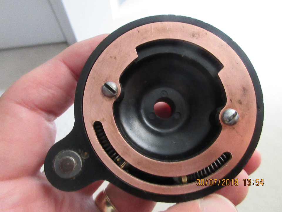

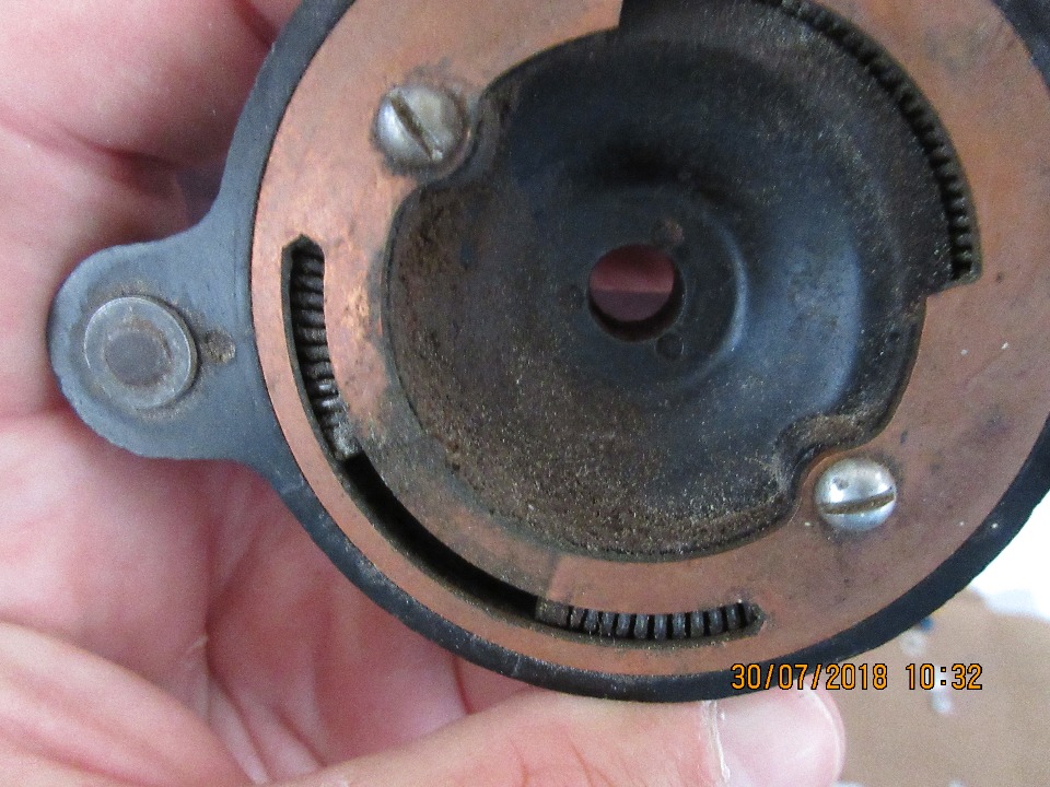

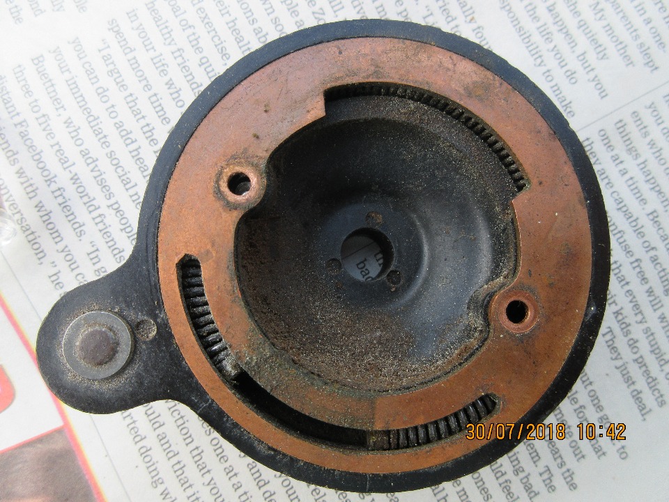

I went ahead and took the switch off and discovered it is full of crud. Took it apart and cleaned everything up. Problem is getting that spring back in place -- I don't have enough hands!!

That cleaned up well and is back together.

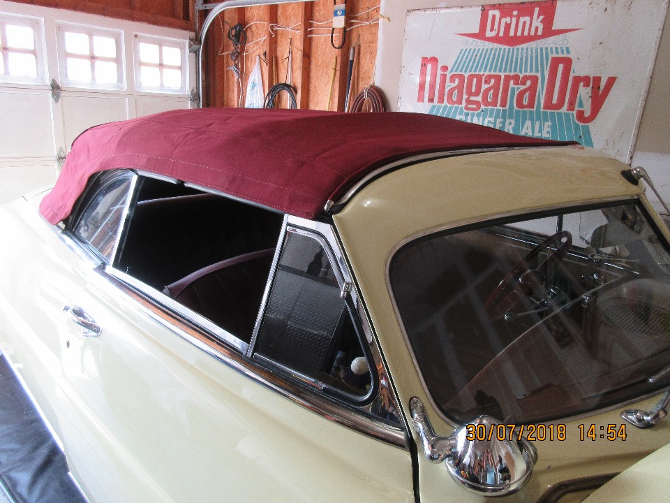

(@Gino DiCiocco)
Reinstalled but still no up power. Disconnected the control rod and operated the switch by hand and, you guessed it, the top went up. Perhaps the control rod was the culprit. That said, the switch was filthy and likely it was only a matter of time before the crud would leave me stuck again. Top is up . . . happy again.
