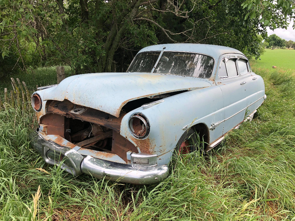

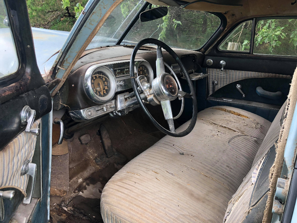

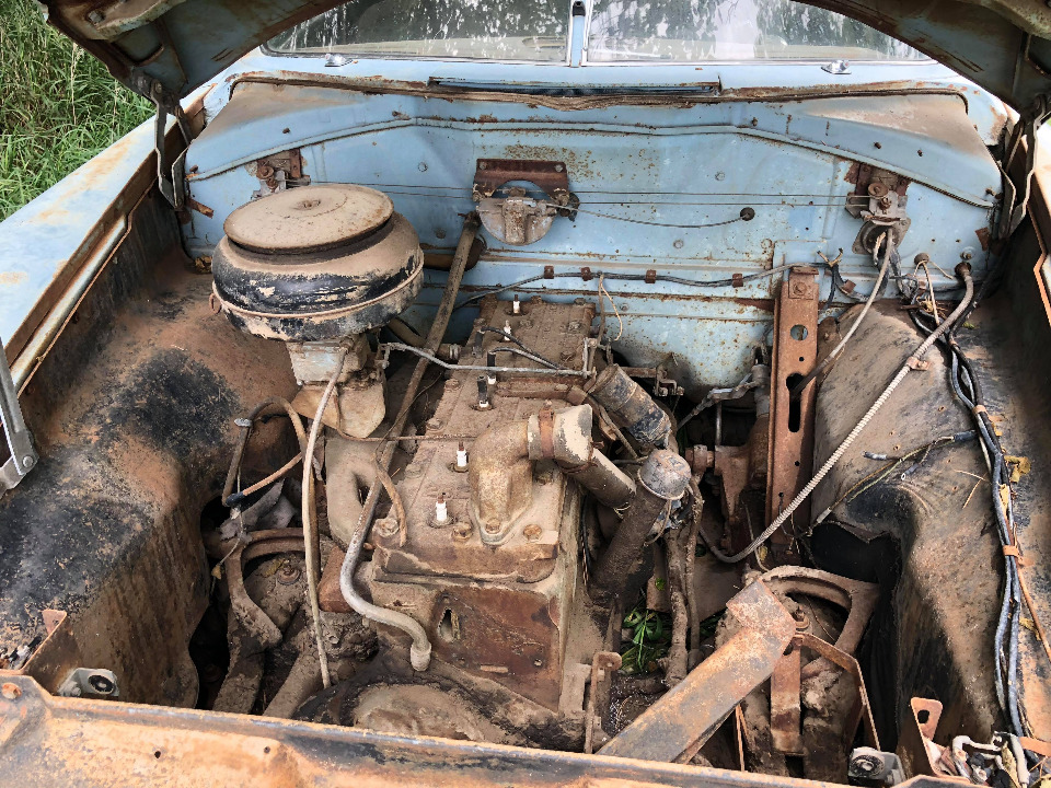

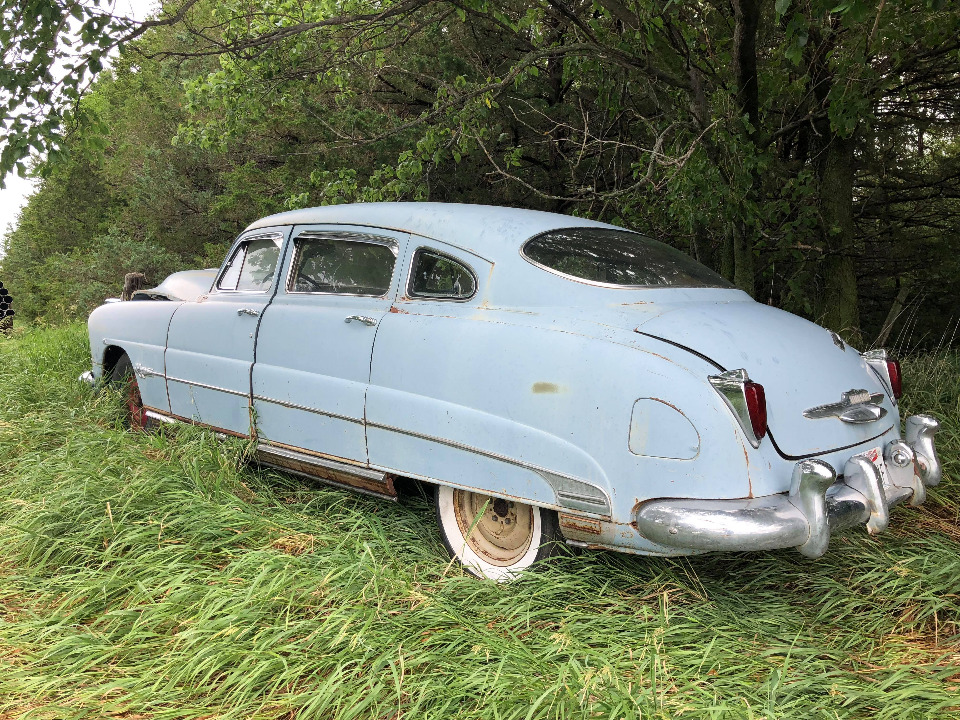

Finally, go a few photo's ready. Not the best, but not the worst. Looking forward to getting it running for cruise night, with my lovely wife.
Posted : 18/07/2018 5:17 am

Looks straight, also bottom doesn't show rust pop thru, good sign.

Looks like a good one to start from. Depending on how far you're going to tear it down, consider replacing the wiring. There's a couple of places that are good suppliers for those, but it may take a couple months lead time to get one. The trim pieces and missing engine parts shouldn't cause you too much trouble trying to locate.

It looks like a very restorable car. I suggest decide on your budget if you want a Show Car or a driver quality car. I like to start repairing the mechanical & safety needs first, then the body, paint, and lastly, the interior. Appears that you have almost everything and guys on this Forum can supply what is missing and also provide advice. Restoration takes a lot of time, patience, and money (All depends on the end result that you desire). Good luck and don't be reluctant to ask questions.[/b]

This 51 looks better with each picture, another good sign. Will be important to get on a lift and examine the parameter frame. 8f its a "go" then I would agree with Chuck's advice unless your plans are for a complete restoration. My experence is that stepdowns are more time consuming then framed cars for full restoration, but yours appears a worthy candidate.
Replace the wiring for sure, as has been suggested. Never trust the insulation on wiring, especially cloth covered wire that is almost 70 years old. I just ordered a complete new harness for a 57 Golden Hawk because the dash harness (plastic covered) started smoking and burned part of the insulation before the owner pulled battery cable off. Car could have burned down.

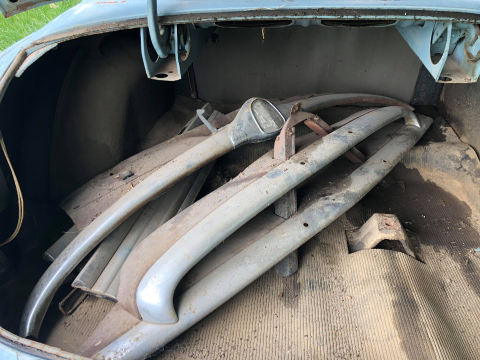

Your fender skirts are in the trunk too, so you can mark that off your list of wanted parts.
