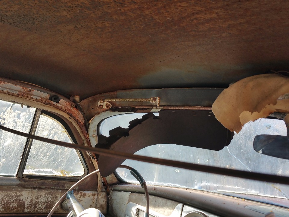

Maybe this picture from a 50 Commodore helps.

Thanks for taking the time to send me a pic. This looks like what I need. Another member said I should be able to feel the visor bracket under the headliner too. Between yours and his I should be able to "get 'er done!"
thanks again.
