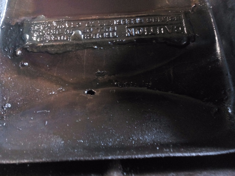

(@Craig Hohm)
The splash tray has small holes in three of the troughs. Is there a best way to repair these?

(@mikew16165)
Posts: 210
Would think soldering would do the trick but have not had that problem to deal with.
