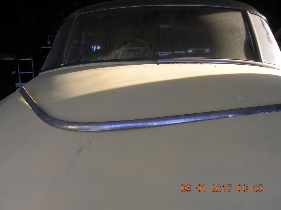

I need the metal strip for this piece of chrome that goes at the bottom of the back glass on the drivers side to attach it to the body

Charlie, Unless you can find NOS curved retainer strips that would accomodate this stainless trim, you will have to settle for getting longer straight lengths and cutting them at about 1" sections and then placing them at the correct curvature to match the stainless trim. Doug Wildrick supplies the retainer strips in the correct length but as I say it will have to be cut and sectioned.
