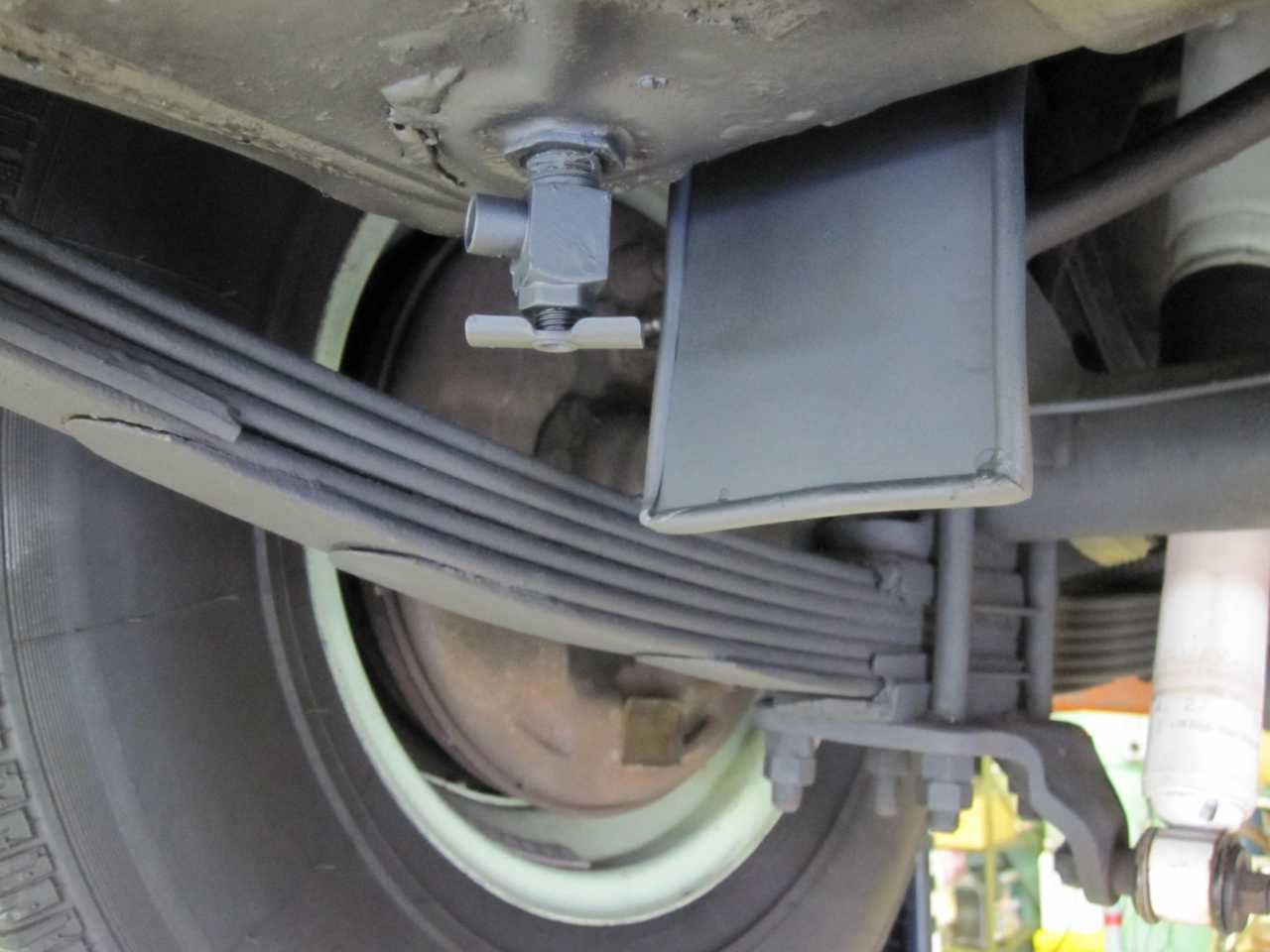

Here is petcock installed for maintenance,etc. Carry hose that attaches & qt jug. Haven't used yet but it is there; directly behind shock and mount so protected & with metal shield. My '53 tank had 2 plugcocks w/one at rear.

Richard, just a quick note about an experience we had with a petcock installed on a 98 Dodge with cummins diesel engine.
I installed one of the aftermarket versions made just for this engine. My son was driving down I-75 and an 18 wheeler in front of him had a tire that started shredding pieces all over the road, my son could not get over due to other traffic and had to run over a piece. Went about 3/4 of a mile and engine oil light came on. Rubber piece had hit the petcock and somehow spun it completely out of the oil pan. No damage to pan or pan threads! He shut it down in time to save the engine.
Posted : 08/02/2017 3:03 am
(@Richard Dryman)
note: I wouldn't have installed this without shield or being behind the shock structure. Also meaning I wouldn't have installed on tank rear plug. Would be visible there and someone might want some !!!
