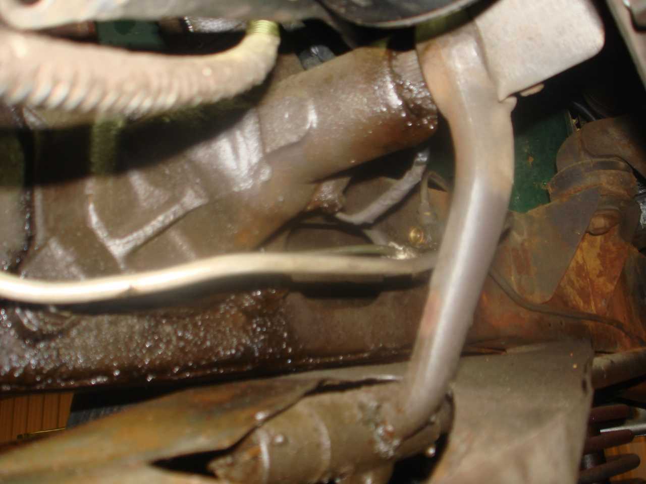

Charles, Have you had this engine running?. Have you removed the fuel tank and restored it?. Was the engine stuck when you got it?. There are so many questions that need to be answered. What is the mileage on the car.?. At the very least, you need to drop the oil pans. This will allow you to do a little preliminary inspection and was something the factory recommended periodically. That procedure is described in your Hudson Shop manual.. It is a relatively easy job, but can be messy . If your car is somewhat original, it should have all the shields that surround the oil pan. These can sometimes be a real challenge, as they did do their job and protect things from coming into the engine compartment, rocks, and everything else. It also allowed oil leaking from the engine, a place to pool or lay, which drew dust. We have removed these before and they weight 10 pounds or more !!!

What Doug said.....I had to deal with those shields to drop the oilpan, replace a brake line, to drain, flush, and refill the clutch on Sheldon's 1941 Super Six. The one on the right (passenger) side even has the exhaust going through a hole in it, ditto for pitman arm & drag link on driver's side.....LOL

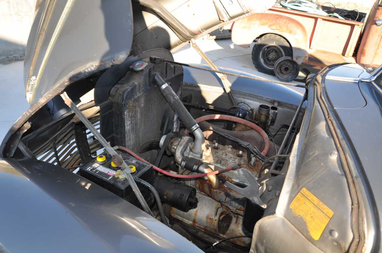

I have the same car with original engine and had pretty much the same problems. Didn't take the engine apart, yet. Did get it to run and drove it around a fair amount (town that is). The head gasket has gone bad on mine and needs replacing as it is overheating the cooling water after coming to a stop on hot days. THe clutch was stuck, but managed to take care of that and there's some life left in it. Eventually it will go to Doug Wildrick for rebuild as it chatters at times on take off. Can pass off some more notes if you're interested.

Eventually, that's in the plans -- will rebuild the engine. But I'm pretty sure the head gasket is gone. Getting some leakage of hot exhaust gas into the coolant. That's what is causing the issue, pretty sure.
