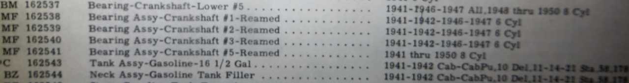

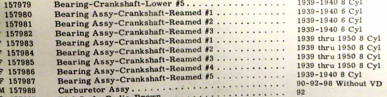

Can anyone out there shed some light on why the#5 bearing #157987 was only used from 39-40 and then the bearing number changed to #162541 for 41-52?(from master parts book)
Does anyone know if NOS std bearings are still out there for the 41-52 254 engine?
Looking for #157984 thru 157986 and 162541

Hi Paul. I'm pretty sure up through 40, all the bearings were installed with shim packs. Beginning in 41 though, the bearing thickness changed a little eliminating the need for shims, then from then on, no more shims.
