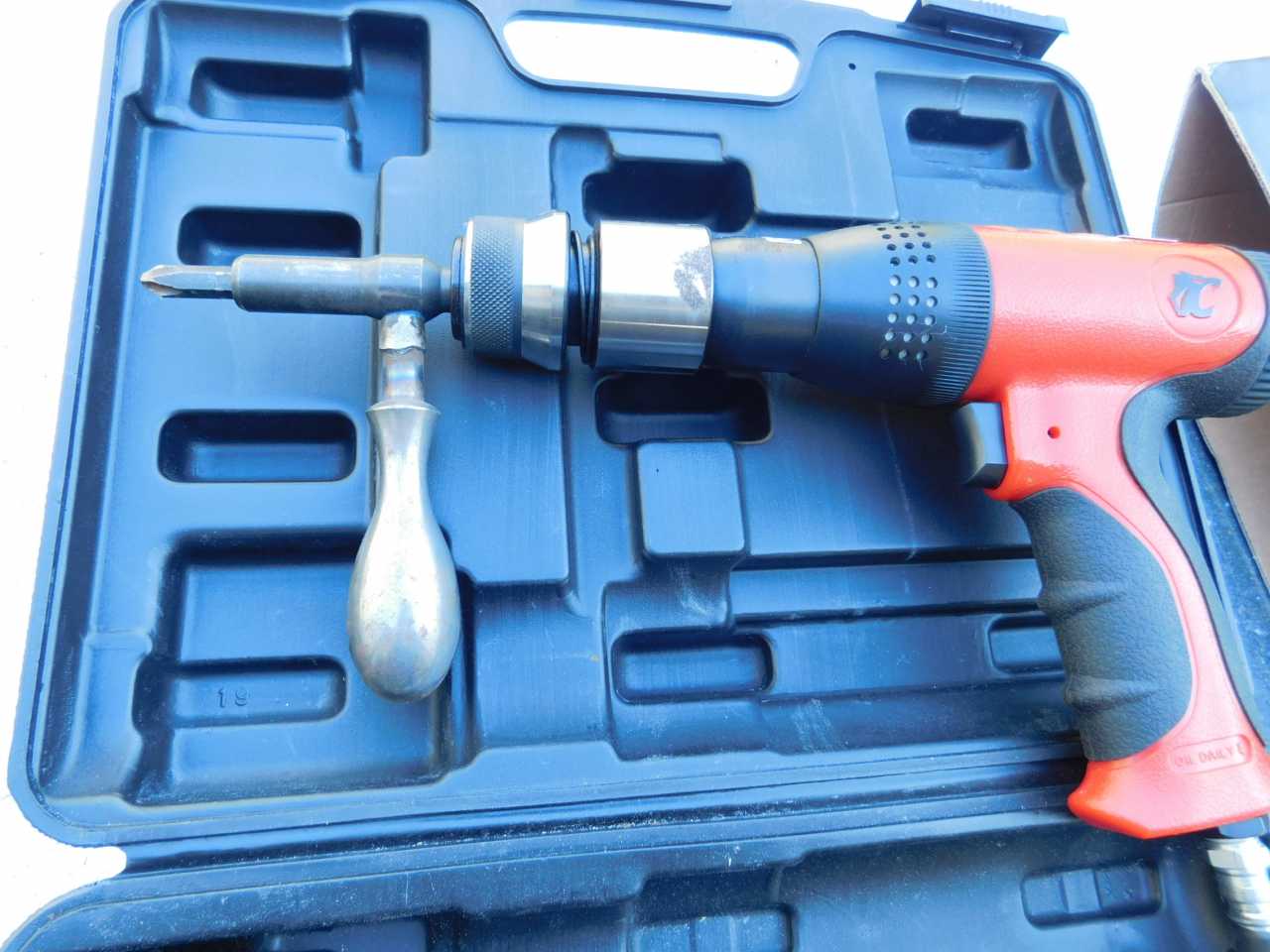

Gary, I missed your first post. I have tried the hammer driver type of impact tool with minimum success.
The Shake and break tool that is used in an air hammer is by far the cat's meow. Great tool for this.

Kerry...That's another great tool. I assume you made this one too? I'm hoping I can get this job done without removing the door.

Gary, click on the link I posted above and it will show you the shake-n-brake tool. You can buy one at most auto body tools store. Autobody Toolmart is that link. I did modify the handle on mine. You will save time, effort and screw heads !
Also highly recommend Kroil, the best penatrant that i have found and i have experimented with a lot of the ones on the market and the homemade concoctions as well.
