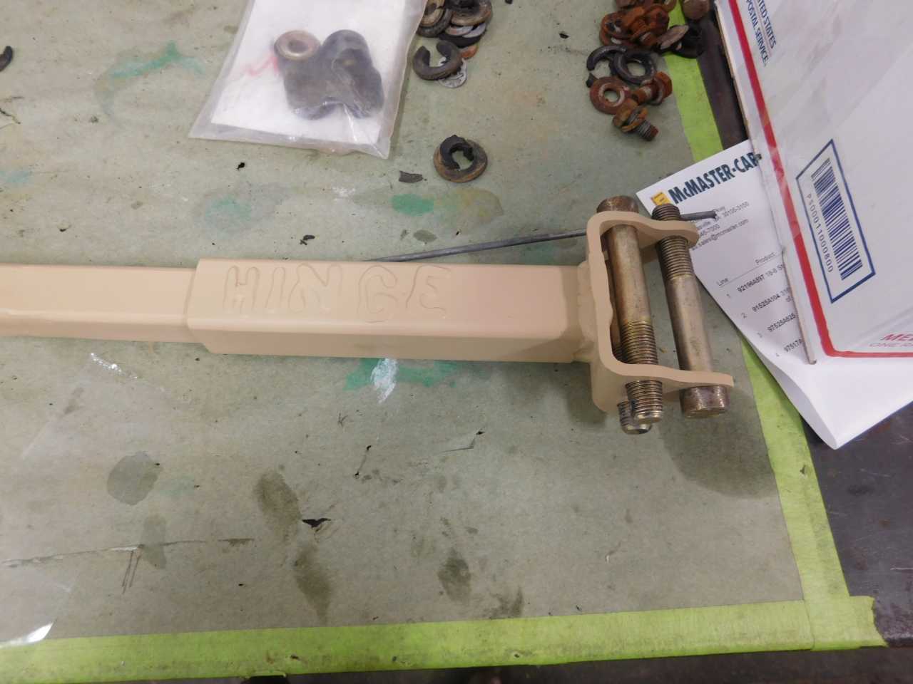

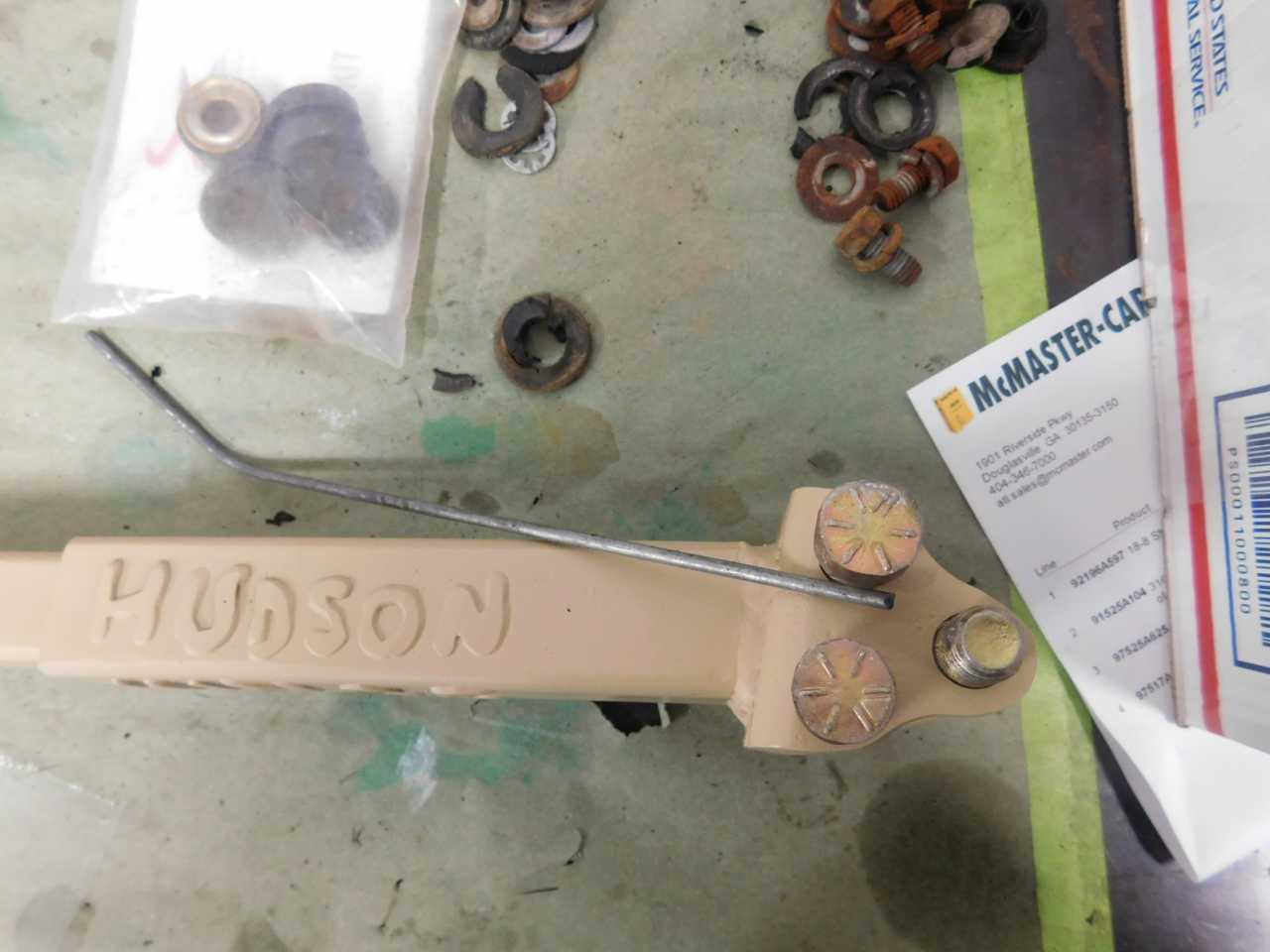

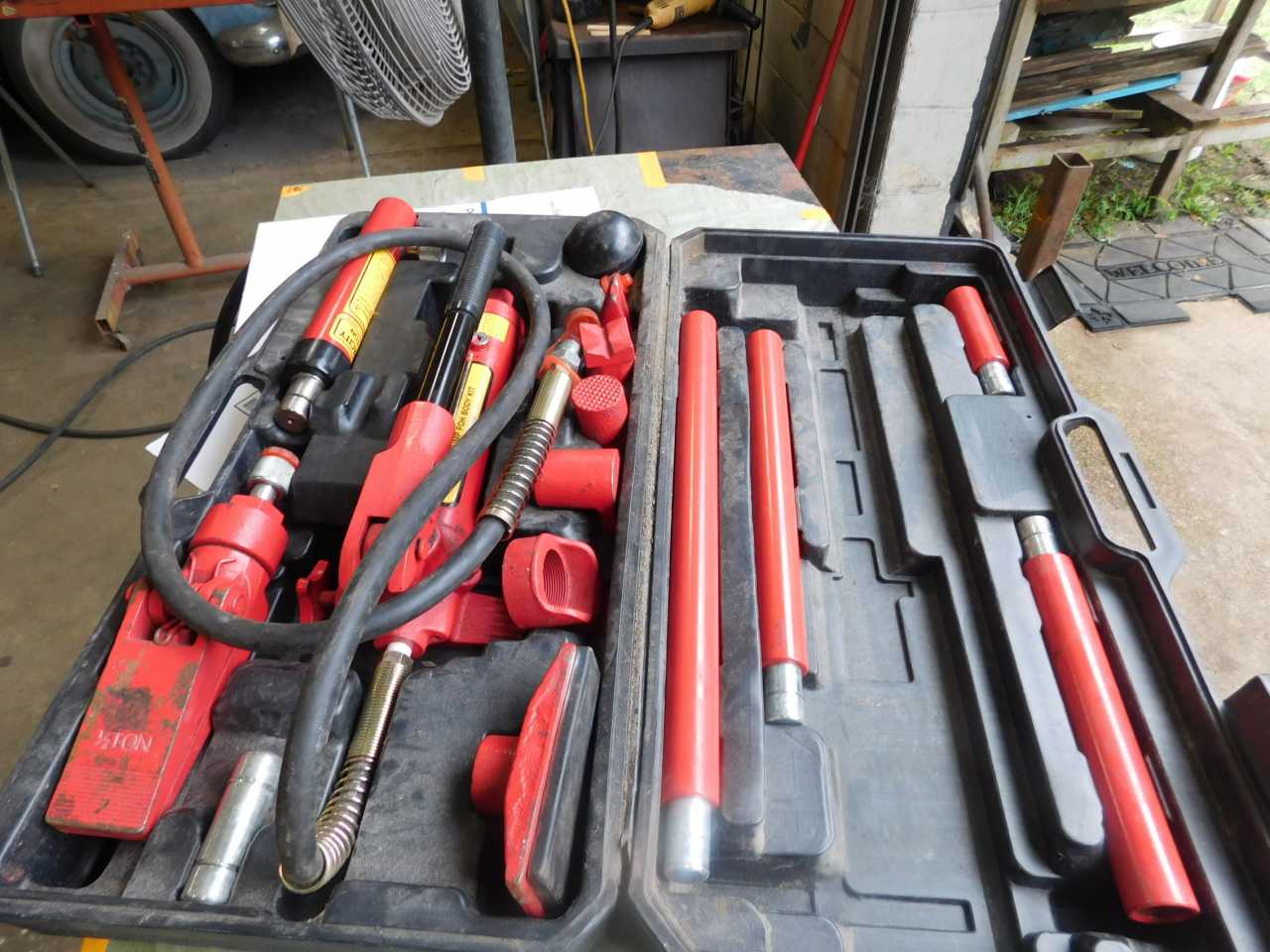

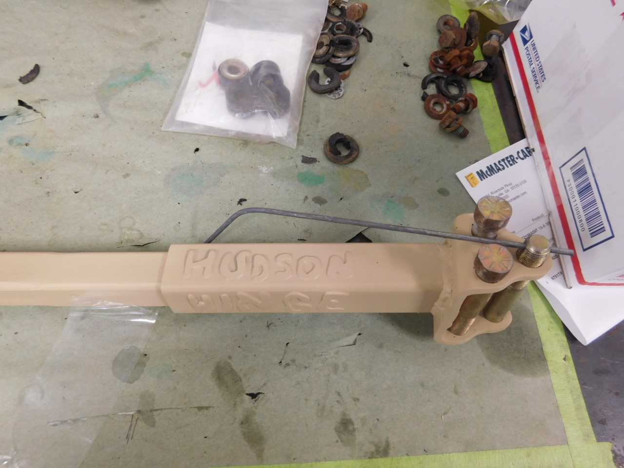

Hudson used a door hinge bender according to the manual. I have never seen one but made a tool up that works very well.
Or you can use a porter power. I could "feel" better when using the tool I made up.
https://1drv.ms/f/s!AlqXTowCsi4UoSCimnadmjL5IMlI
Here is a link to pictures on onedrive.

(@pfeifer)
Posts: 724
Prominent Member Registered
Another thing about using the hinge tool over tge porta power, its much easier to reverse if you bend a tad to far.

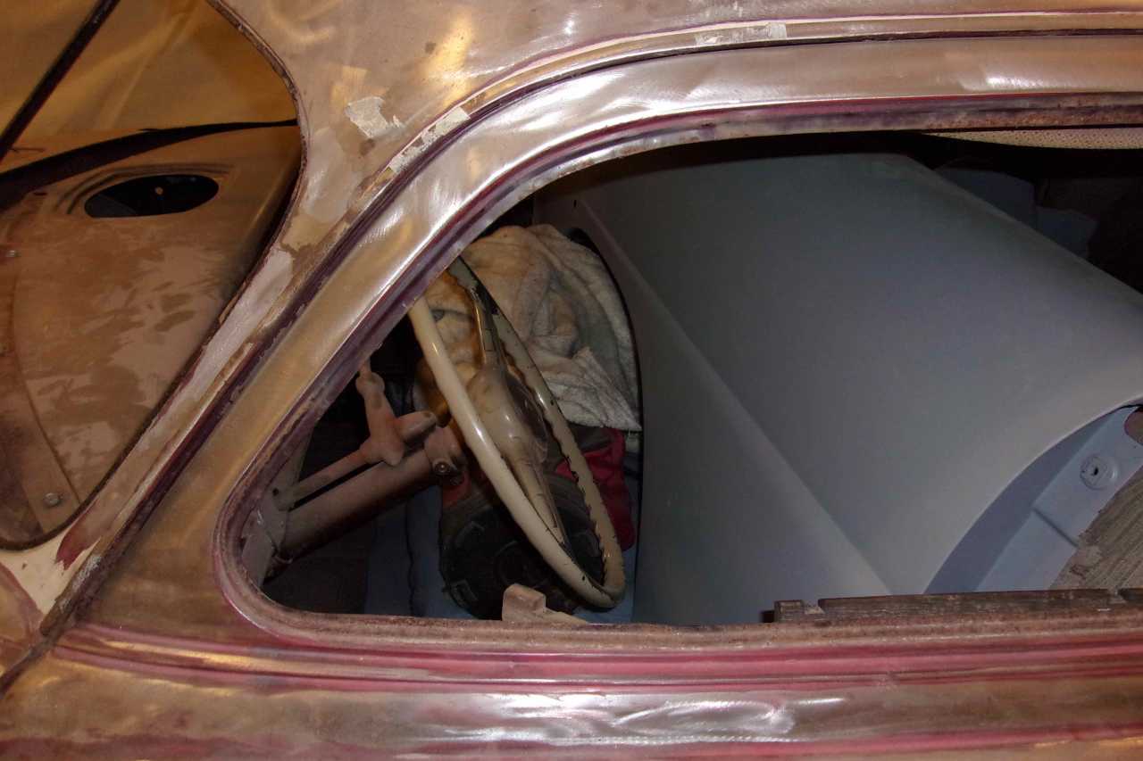

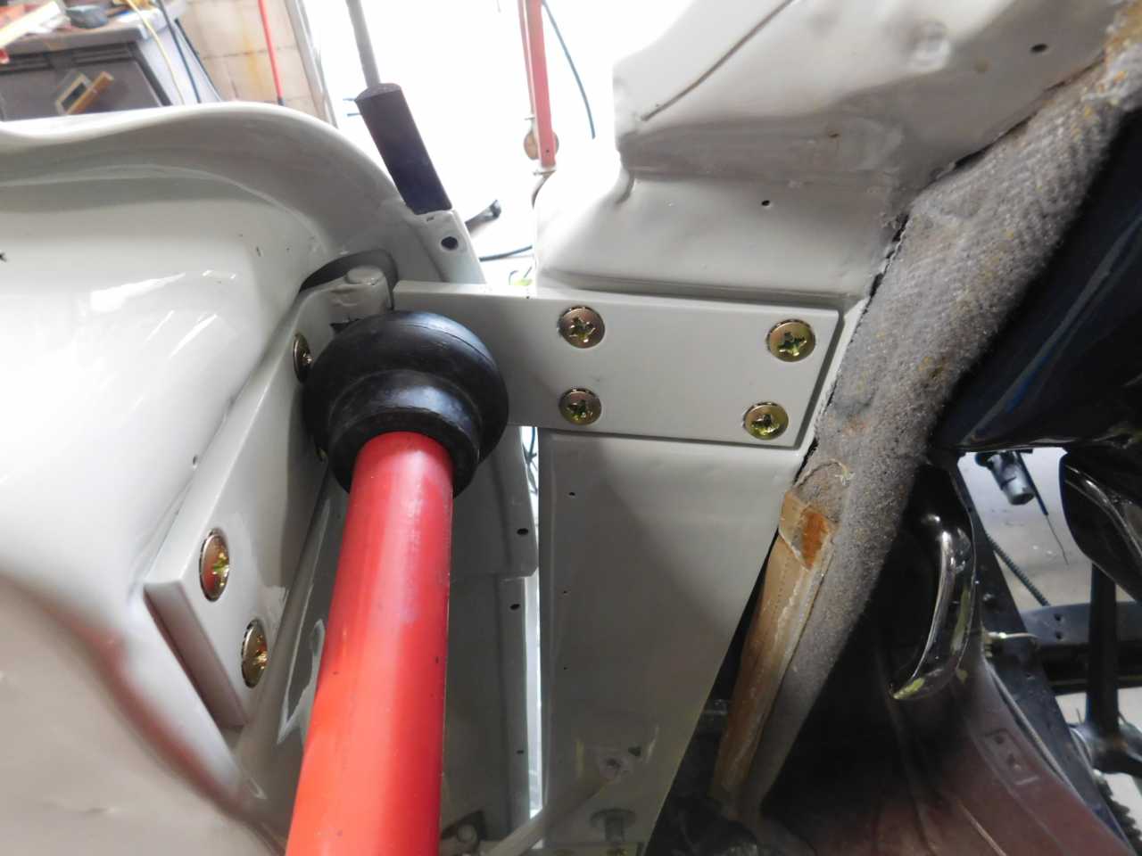

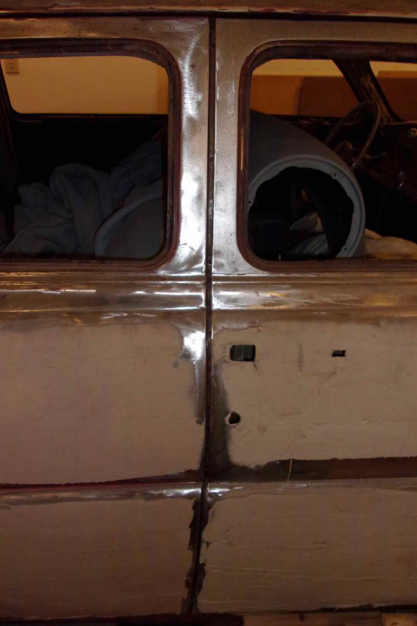

(@sean-mccabe)
Posts: 57
Trusted Member Registered

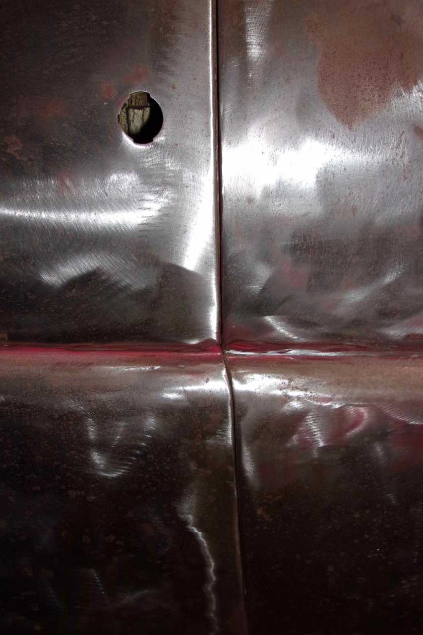

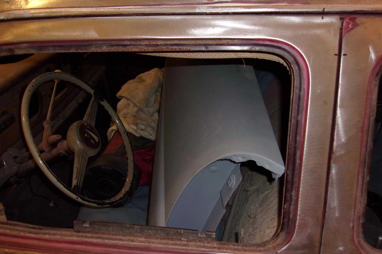

Here are some photos of both the passenger and driver side doors. You'll see that the passenger side gap is a bit wide at the top and narrows just a little towards the bottom. However, the horizontal lines align well so I don't want to alter that. (Ignore the Bondo...that's someone else's handy-work and will be removed.) The driver's side is quite a different story. The door alignment to the roof line is pretty good. It starts to get tight at the upper portion of the front door to rear door though there is still a gap. Then the door interferes at the crease in the belt line all the way to the bottom of the door. Hopefully these inspire some suggestions.

[quote="Kerry Dancy" post=18824]Another thing about using the hinge tool over tge porta power, its much easier to reverse if you bend a tad to far.
Kerry...I like porta=power and hinge tool. Does the front pillar have enough stiffness so that the hinge bends rather than twist the pillar? Tried doing a little bending with a long pry bar but the pillar seemed to do all the movement.

Kerry...I've been studying the hinge tool you made. Can you use the tool with the door attached? I assume the three bolts are placed on either side of the exposed portion of the hinge that extends from the pillar. Is that correct?
Posted : 02/01/2017 2:06 pm
(@pfeifer)
Posts: 724
Gary, make sure the A piller is properly attached/welded in place and not rusted out at the bottom.
On the tool, i pull out the back single bolt, place the tool into position against the hinge, pop the bolt back in place then apply pressure
In the direction i want to bend. This is done with the door installed. If i want to change sides, i flip the tool over. Notice the handle angle
Is not 90 degrees.

(@David Carpenter)
Great info Kerry, thank you. Gary, also take a look at frame underneath door, to ensure not bent upward, and try to ascertain if there was a front impact that could explain the rearward displacement of the A pillar. Because, according to your gaps, if a ram is going to be used to bend a hinge forward, it is the lower hinge- a bit unusual.

Kerry...I now see how it is used. Very clever. Thank you! How long is the bar that extends from the hinge attachment point?

(@pfeifer)
Posts: 724
Gary, if everything looks good and solid you should be in good shape.
I purposely left the handle short for maneuverability while using. It is made so i can slip on a longer bar to give more leverage if needed.
It doesnt take much! The hinge bends easier than you might believe.
I want to thank Ken Cates and Doug Wildrick whom gave me the initial info for using the porter power, that info and usage led me to build the hinge tool.
