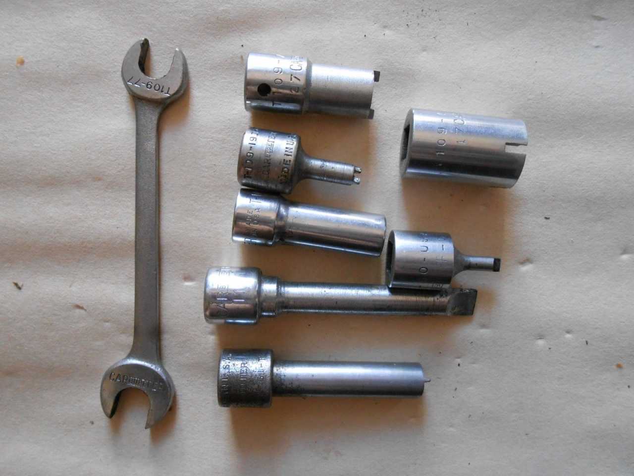

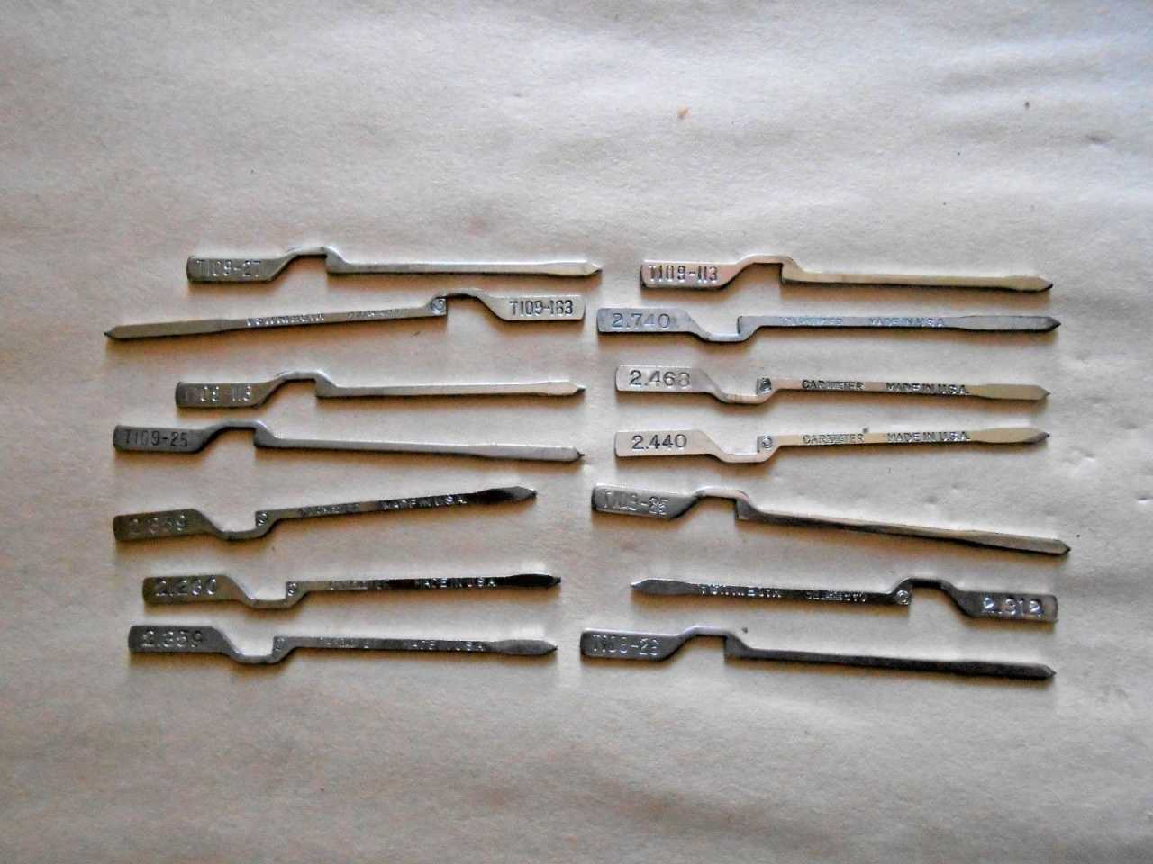

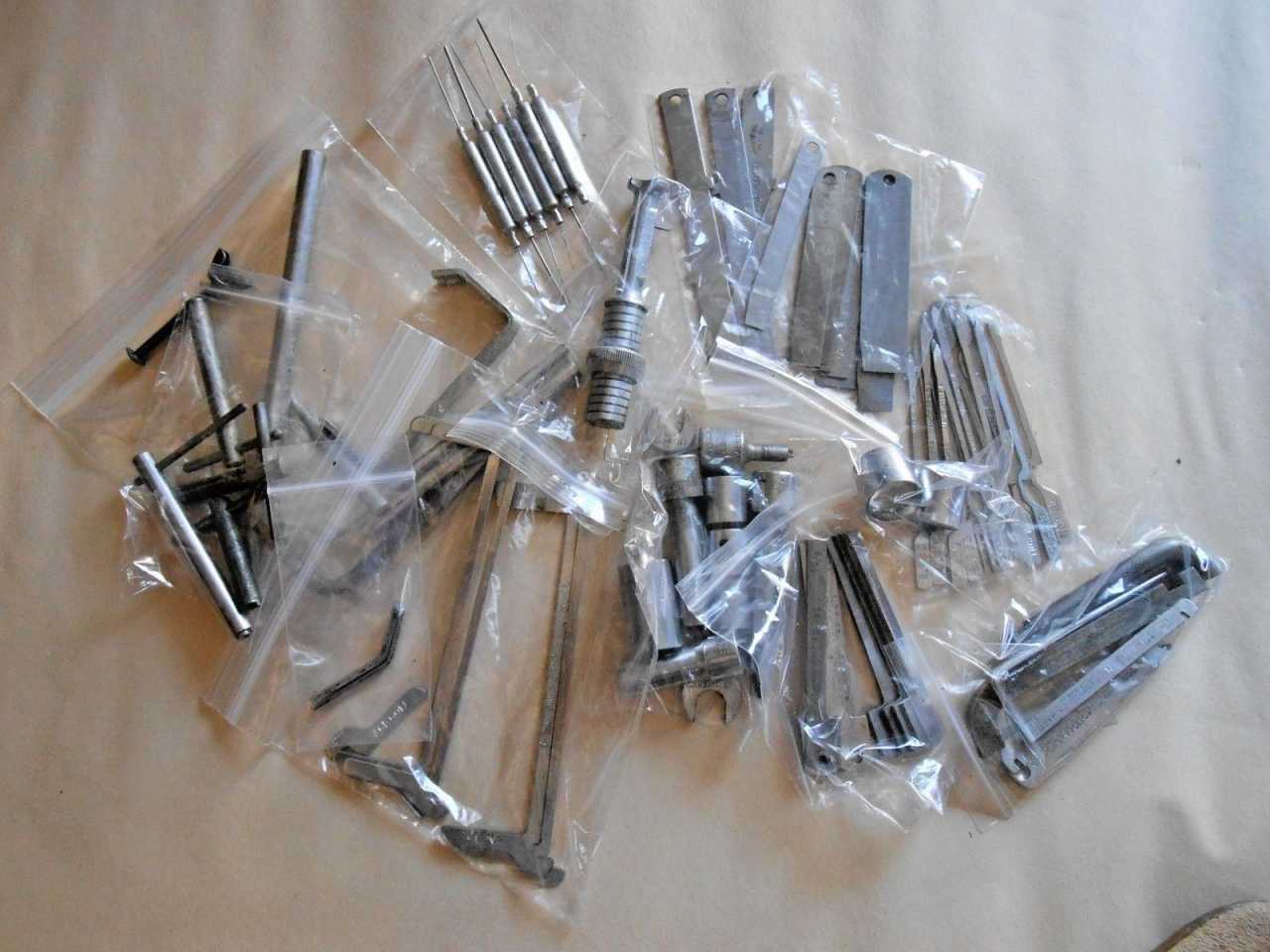

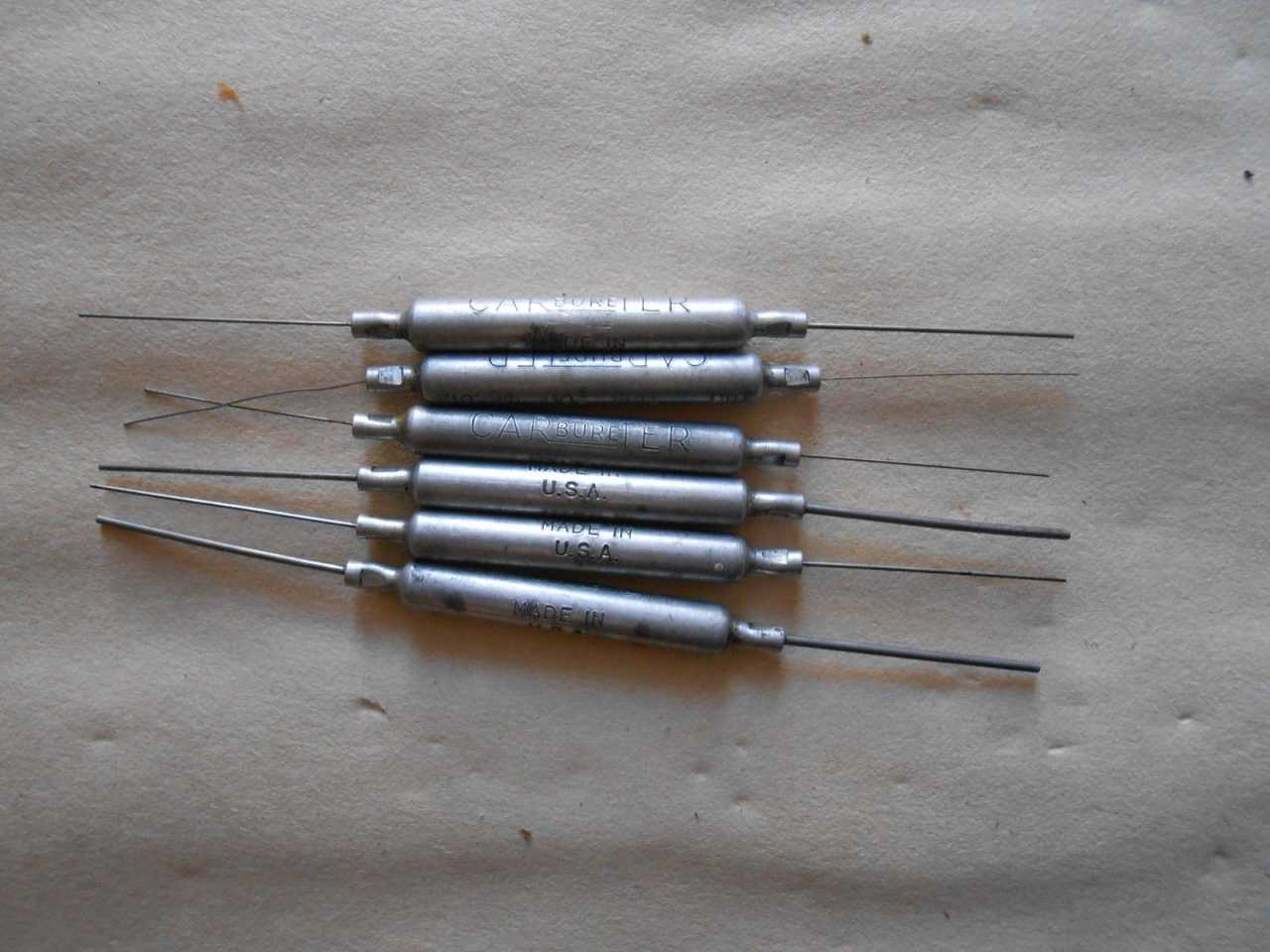

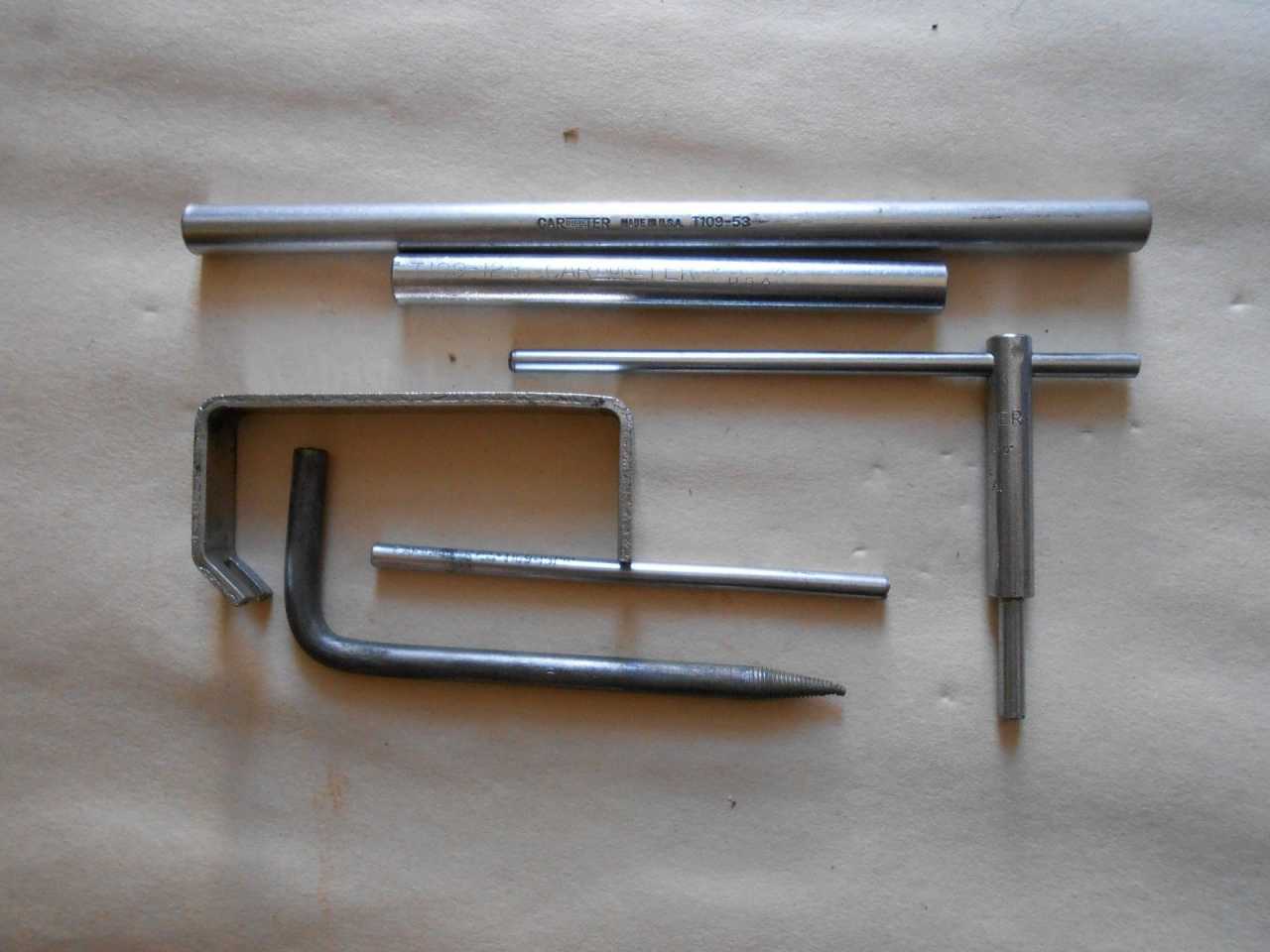

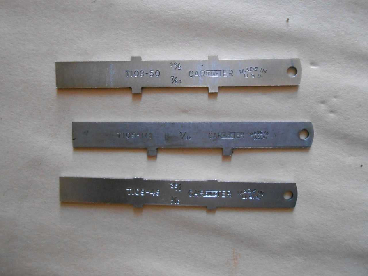

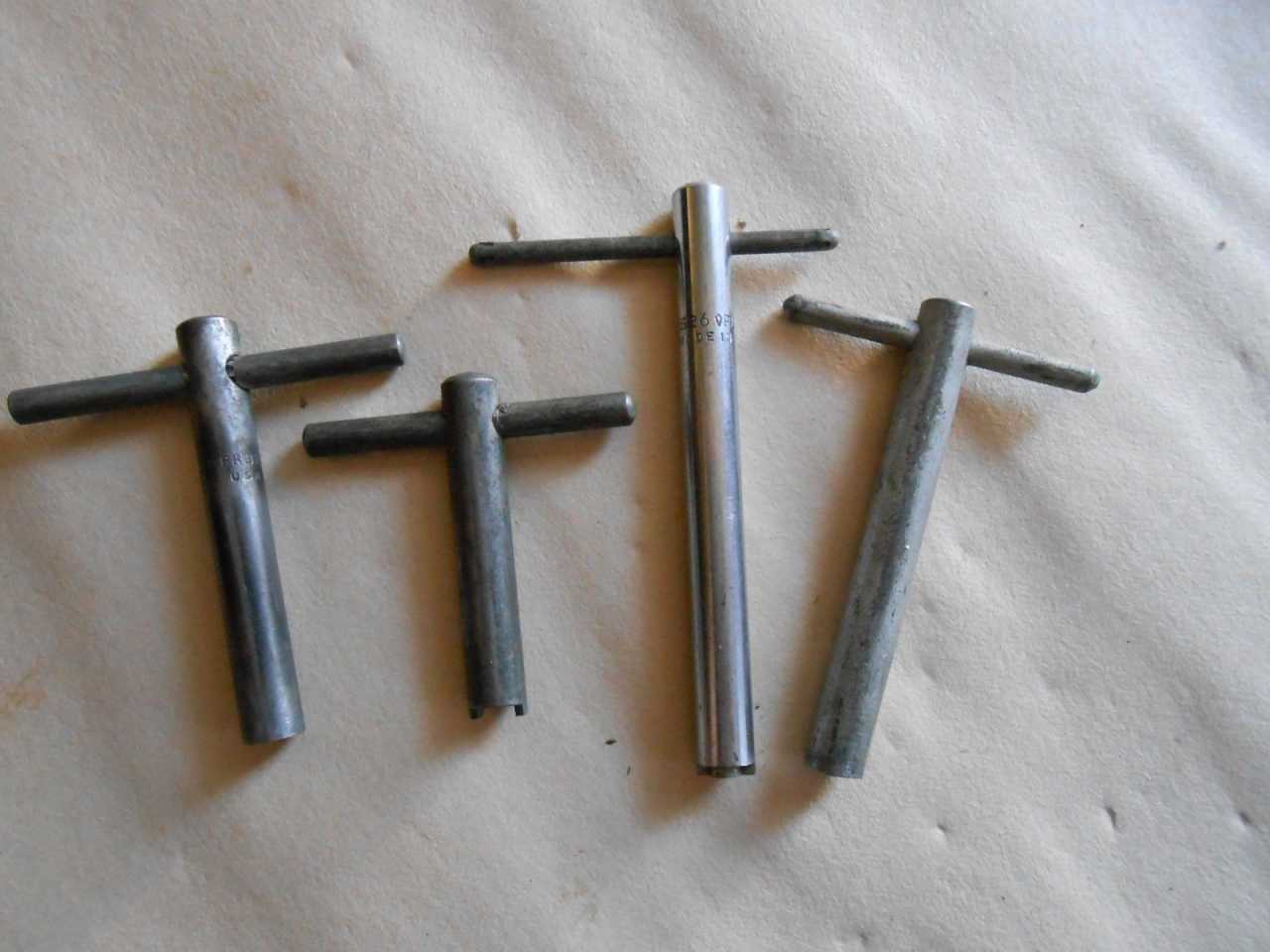

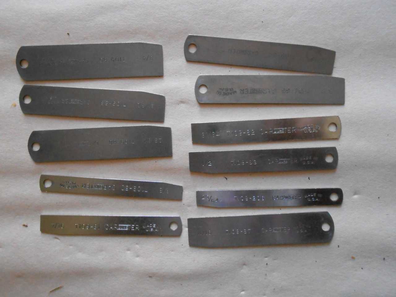

That's why I always rebuilt my own carbs for years now. I have in fact rebuilt carbs for other HET'ers. I have rebuilt WA-1's, WDO's, & WGDs' from Carter. Then there's the Solex's from Citroens and VWs. I have rebuilt 6 Jikov 30/30 SSOP's for Tatra T603 owners. I have acquired a complete set of vintage Carter carburetor tools to properly do the Carter Carbs of the 30's,40's and 50's from a veteran mechanic in NY. Takes all the guesswork out of setting the metering rod eights, the unloader, the saxophone key anti-percolators, etc. Planning on getting a Sharper-Tek carburetor sonic cleaner, which does and outstanding job of cleaning the castings and passages without the need for harsh chemicals
that eat the plating or anodiizing off. Also want to get the Caswell zinc plating kit, and some dichromate to restore the silver and cadmium style finishes, as Daytona Carb no longer does this.

(@adamb)
Posts: 320
A few more pix of the Carter Carburetor tools:
Posted : 30/12/2016 5:46 am
