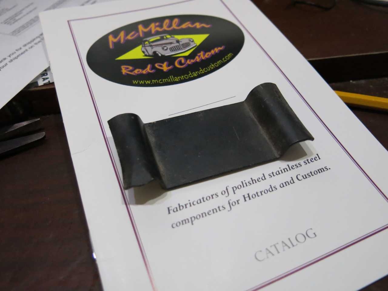

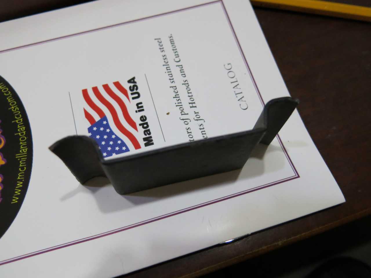

When you get a car that is mostly apart you find part you just can't id. Well here is one that has me stuck.What is it and where does it go.?

Is there a suggestion that a stud was welded to it? Looks like a stainless retainer of some sort.
Posted : 08/10/2016 11:03 am
(@David Carpenter)
Could have been spot welded to rocker panel but popped off
Posted : 08/10/2016 11:05 am
(@csetzcohotmail-com)
Posts: 307
Honorable Member Registered
doesn't look it has ever been spot welded. Had a suggestion it might go on suspension.

[quote="Gordon Eatley" post=18198]doesn't look it has ever been spot welded. Had a suggestion it might go on suspension.

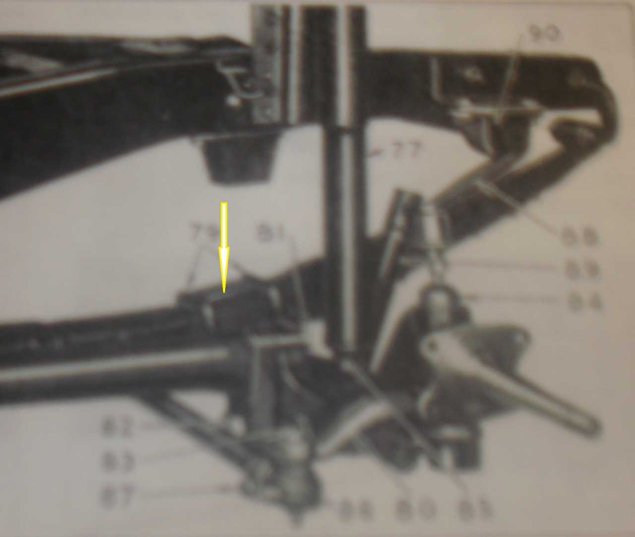

Yes Gordon, it goes on the top of the front leaf spring, and is held in place by the two U-bolts that hold the spring to the axle. it serves as a plate for the rubber bump stop on the frame to contact.
Posted : 09/10/2016 5:24 pm
(@adamb)
Posts: 320
Strangely, even though this plate is shown in the photos, it is not listed as a part! Weird......but then even Hudson made small errors of omission in their shop manuals....LOL I spotted many errors in the Stepdown shop manuals.

So you need one to supplement the one you have? I would imagine any good sheet metal shop could fabricate one from heavy gauge sheet steel. I could fabricate one but would need a drawing of the length, width, depth of the 90 degree bends and the radius of the curved flanges that the U bolts clamp on, along with the thickness (gauge of the steel).

Well I went ahead and made one my self. Turned out to be pretty easy. Bent it in a vise and over a rod to do radius. One less thing on a list a mile long.
