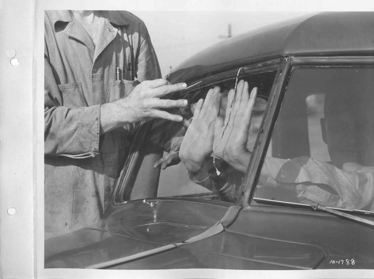

[img] [/img]

The guy inside the car looks like he's squinting his eyes and giving a "please don't bash the window in with a hammer" look while pushing against the glass.
