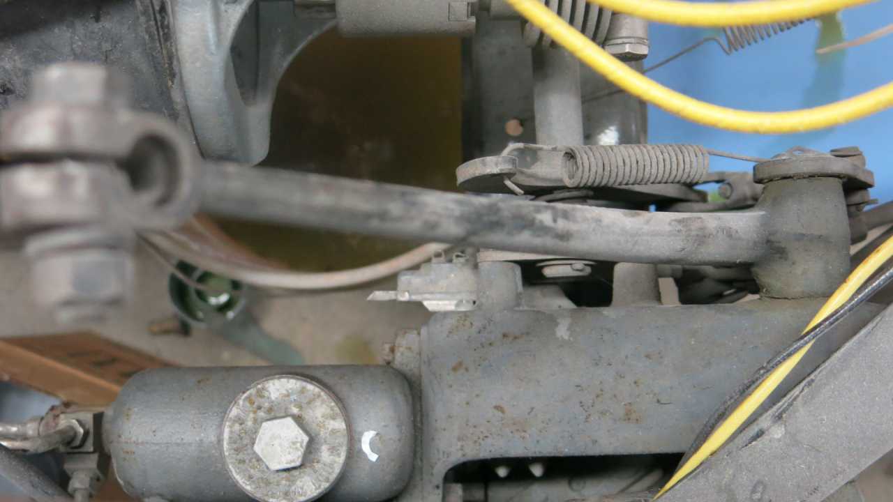

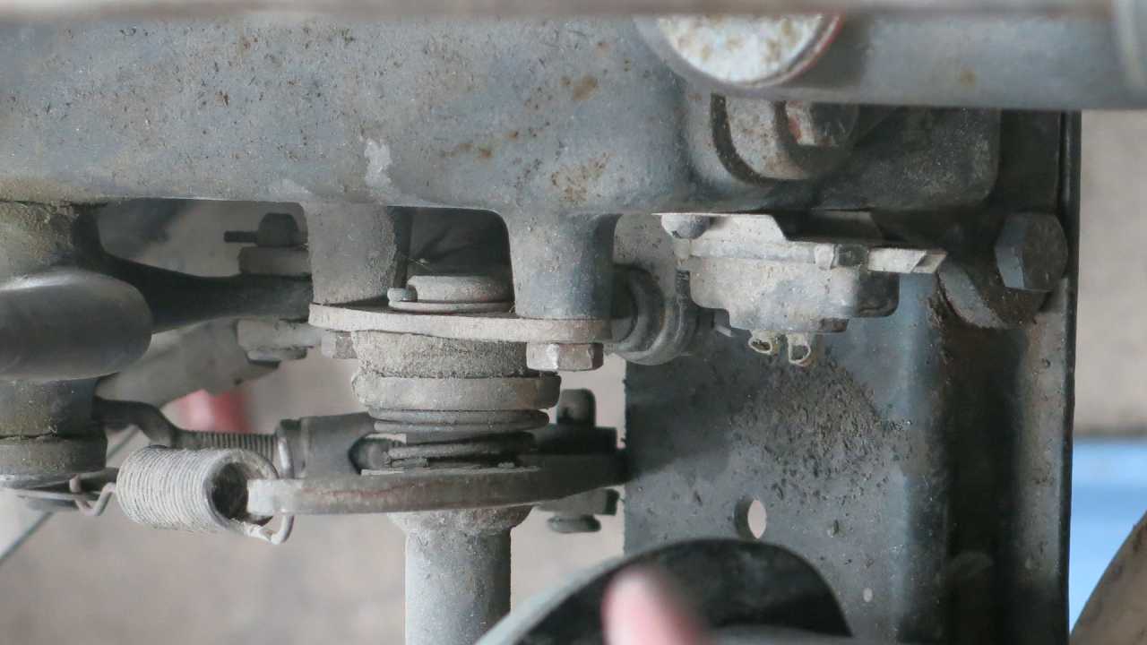

Here are some photo of where my switch is. It is on the engine side of the Pedal/ brake cylinder assembly

Gentlemen, thank you very much! Especially Gordon, thanks for going to the effort of taking and posting the very useful photos!
