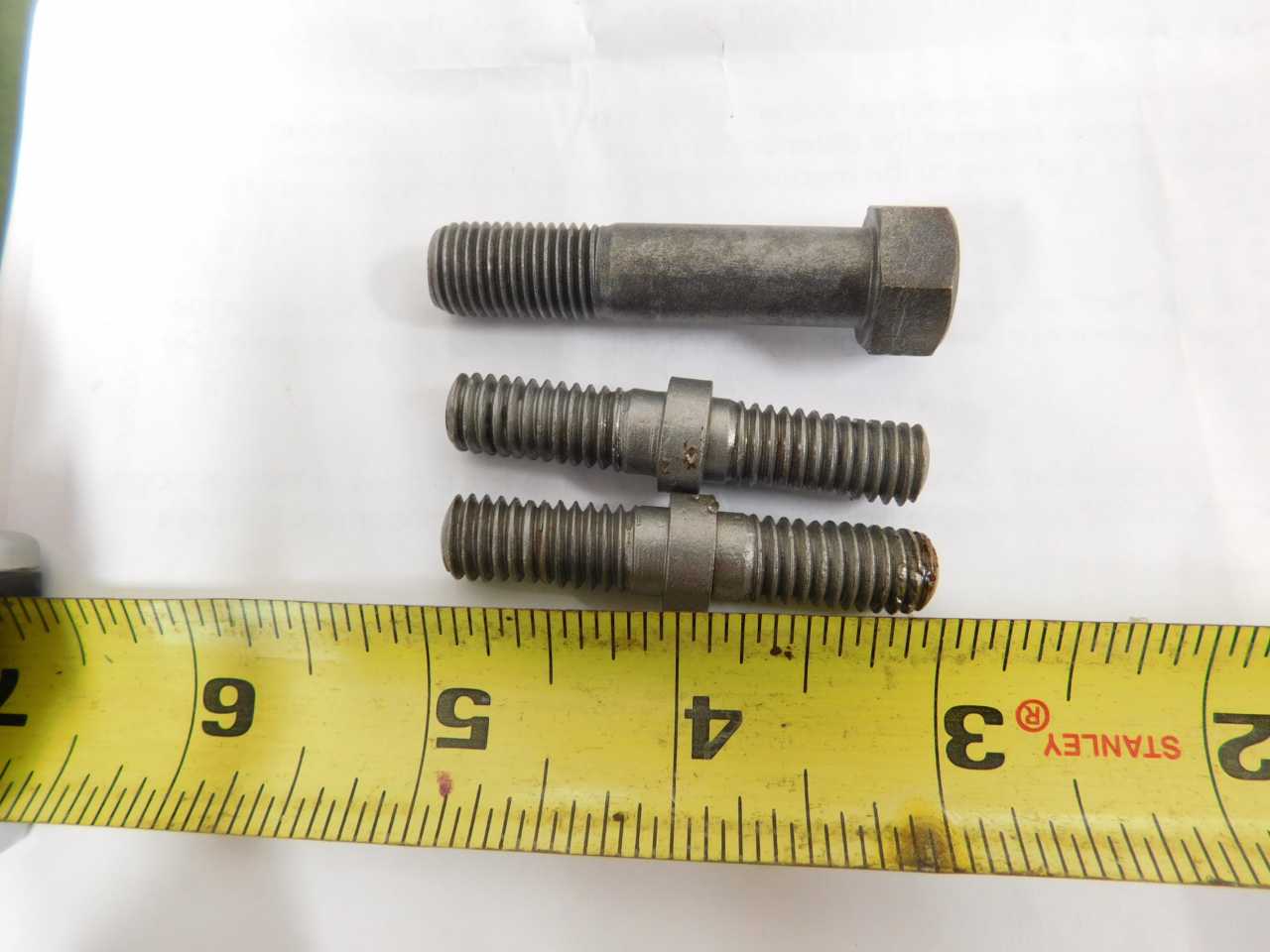

The two studs with middle shoulders are Hudson starter studs. 3/8 x16 x 2"
The other bolt is actually a special shouldered bolt that Studebaker used on their V8/ starters. The same issue creeps
up when using a regular bolt to replace the special shouldered one.

I believe we have a winner!!! The lower stud on the 262 has that shoulder pretty much wiped out, and the upper is also more loose than I remembered. They were probably used loose for some time, and the starter was cocking when starting the car, and wore them down. I've got a bright shiny rubbed area where the shoulders used to be.
Okay, that was cool, I learned things. And your pic made everything much more clear. I guess removal of these studs is done by separating engine from tranny, and they pop out, right? Question is, are they available for purchase from anyone?
