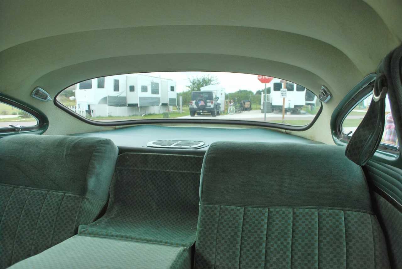

(@Richard Dryman)
Here is my rear shelf in green. Is the same as the kick panels in front. This is not concours, but what I have. Vinyl-look-like on board !!
Posted : 06/07/2016 2:58 pm
(@Glenn Hebblethwaite)
Looks sensational Richard. My rear shelf, door cards trunk cards and kick panels were all made from a generic panel board used by any upholstery shop too. Not "that black fiber like stuff that looks like fiber impregnated with asphalt or some such black mastic". I was looking for it for other locations.

Richard
Where did you get the green upholstery?
