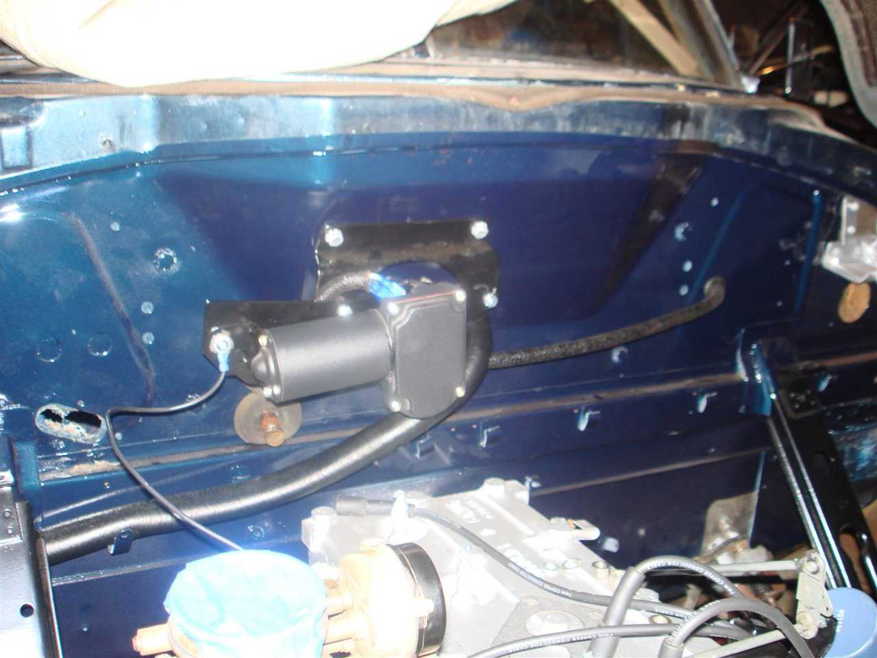

If you are not restoring the car to AACA standards, then there's always the electric conversion option.

(@fisher)
Posts: 41
Trusted Member Registered
Ken;
Ca you post some more info on that electric wiper conversion?
Motor Part #, does it work with original cables, etc.

(@adamb)
Posts: 320
https://www.newportwipers.com/products.php?year=1951-54&make_id=17
Yes it works with the original cables.
