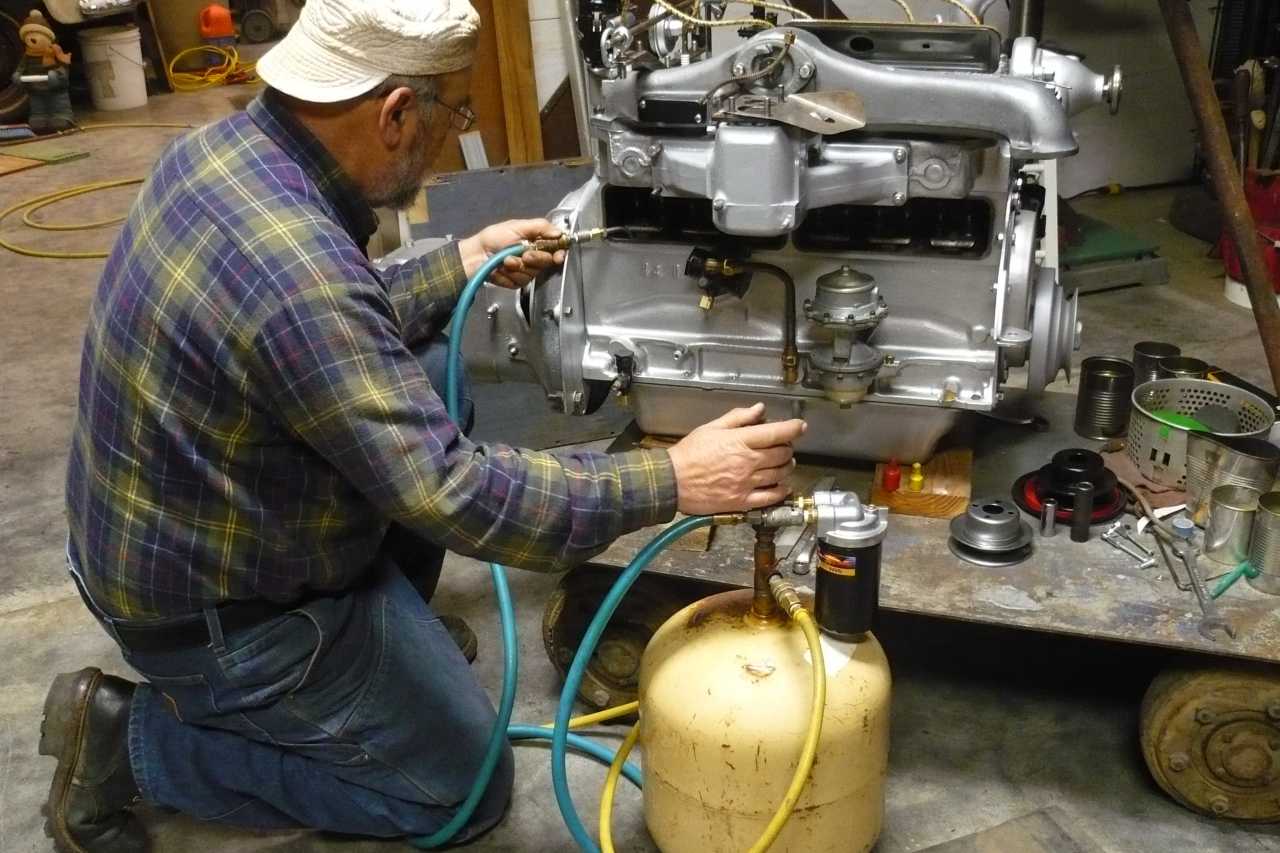

The book says to pre-fill the tray before putting it on (obviously not possible with the engine inverted) but a better way is to pour a couple of quarts through the tappet chamber drain holes. It can be messy if you try to go too fast. I use a pressure pot to do that task (see photo if it made it) but it can be done otherwise. Pour [i]at least[/i] 2 quarts through those holes, moving along to get it distributed. The main and cam feed troughs are just below those holes so this method pre-lubes those as well. As you said, any excess can be drained afterward.
Those engines don't have any internal components that are pressure lubricated.....it's strictly a "splash" lubricated machine. If you didn't pre-fill the tray, there was no oil for the rods to dip and so, none was "slung" up onto the crankcase wall to feed the mains/cam. Hopefully the engine was assembled with generous amounts of assembly lube.
