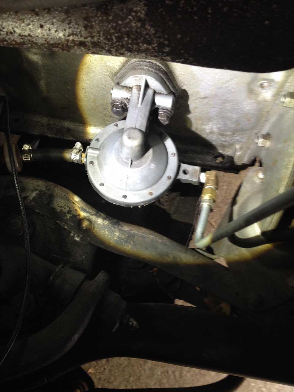

I found today the fuel pump on my 50 Comm 6 was pushing gas through the vent hole above the inlet side. So, I conclude the diaphragm has a tear. The car is at my buddy's place, not here at my garage. I've rebuilt dual action AC pumps in the past, but not a fuel only Carter. From the basic images in the 48-54 service manual, I believe what I have is the Carter, but I also know there were aftermarket units.
Before I find a rebuild kit, does anyone know whether this is indeed the original type Carter?

Pat, what you have pictured is a single action AC type pump that is correct for any stepdown . Largely these came typically on Super series cars or Pacemaker/Wasp vehicles. In the early 1950's Hudson additionally used single action Carter pumps on the Pacemaker and Super series cars but by 1952 they were mostly switched over to the AC single action pump. Nothing wrong with the Carter pump. Actually easy to rebuild. The story I have heard was that Carter was pressured by GM to get of the fuel pump business for various reasons and did so to avoid future financial and legal problems. Carter also built a double action pump as well. In addition to the AC OEM pumps there are also a lot of Airtex pumps who were authorized by GM to sell virtually identical replacement pumps

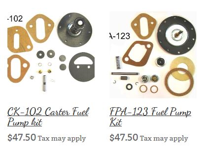

Thanks. The team at Now & Then Automotive suggested the 'FSA-123' kit for it, but I don't know whether that means it is an AC or something else. They believe it to definitely NOT be a Carter; if it had, the N&T kit would be CK-102. They're asking me to remove it from the car to remove the doubt. I get that.

Pat, It's FPA 123 AC single action..It is NOT a carter.

As Lance stated, it is an AC single action pump. The Carter has a different profile. You also need to loose all the extra fittings on the out side.

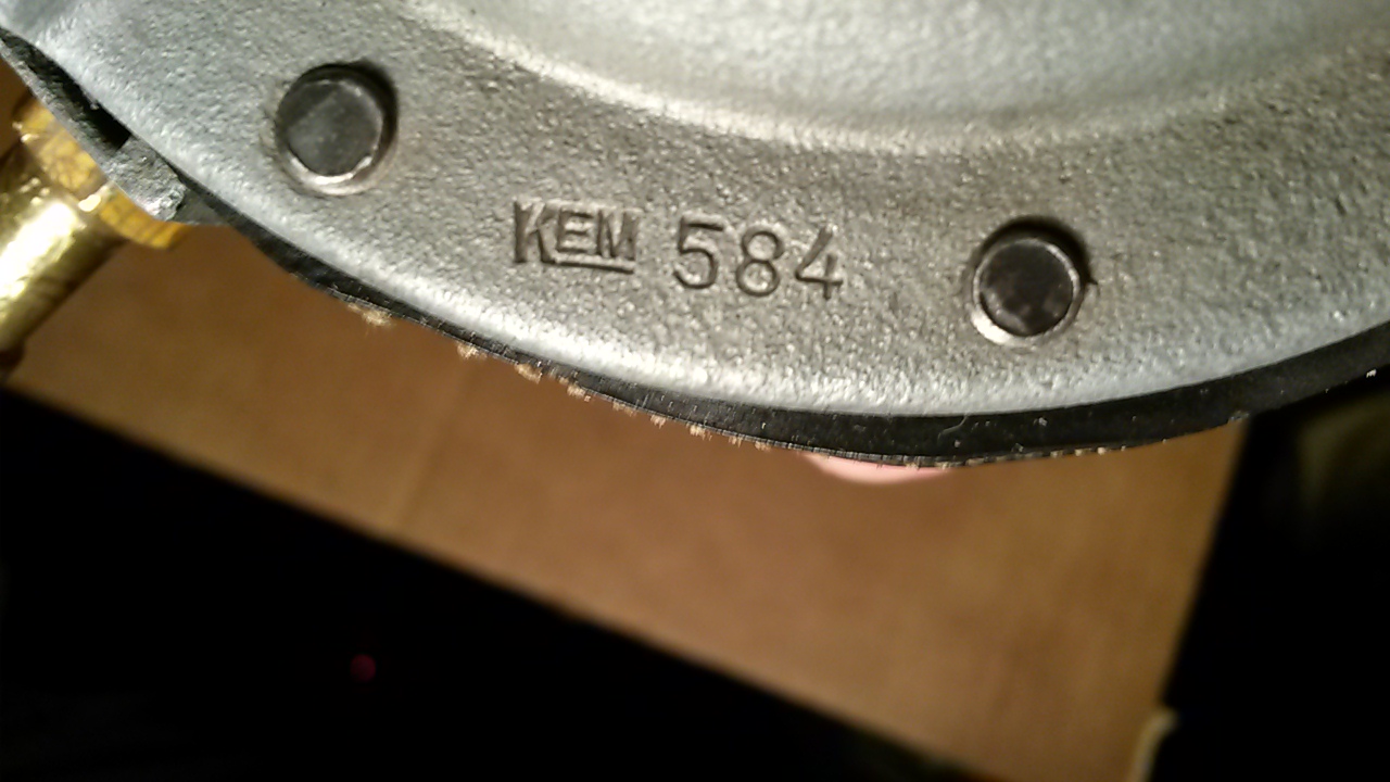

Lance, Doug: Exactly correct. I pulled the pump last night and upon inspection confirmed it as an AC based on the outlet casting (photo); further it was rebuilt by KEM (aftermarket supplier back in the day) based upon the flange stamping "KET" (photo). As is typical, the flange part number was filed off, which the aftermarket repair companies routinely did. Finally, the number 584 confirms it to be the original AC single action version (image from AEA service note).
Doug: you don't miss anything. The cobbled up hose clamp, plastic filter, hose clamp all adjacent to the exhaust will be going away. THis is another example of my plans to undo things on the car as I found them. The entire line back to the tank appears original, fittings and all. That too will be replaced in the next week or so.

That's not a rebuilt pump. It's a new manufactured pump by KEM. Kem was located in NJ from the 1920's or 1930's until at least 2005. I believe they were sold to someone and moved to South America.

I didn't know KEM still had such a recent presence, but pretty sure part of their business was rebuilding other companies' pumps. Perhaps the rebuilding itself was done by localized shops, I don't know.
Regarding my pump, it clearly has an 'AC' cast at one of the ports, the patent information on the flange and what appear to be the AC Part numbers on the cam rocker and other parts.
